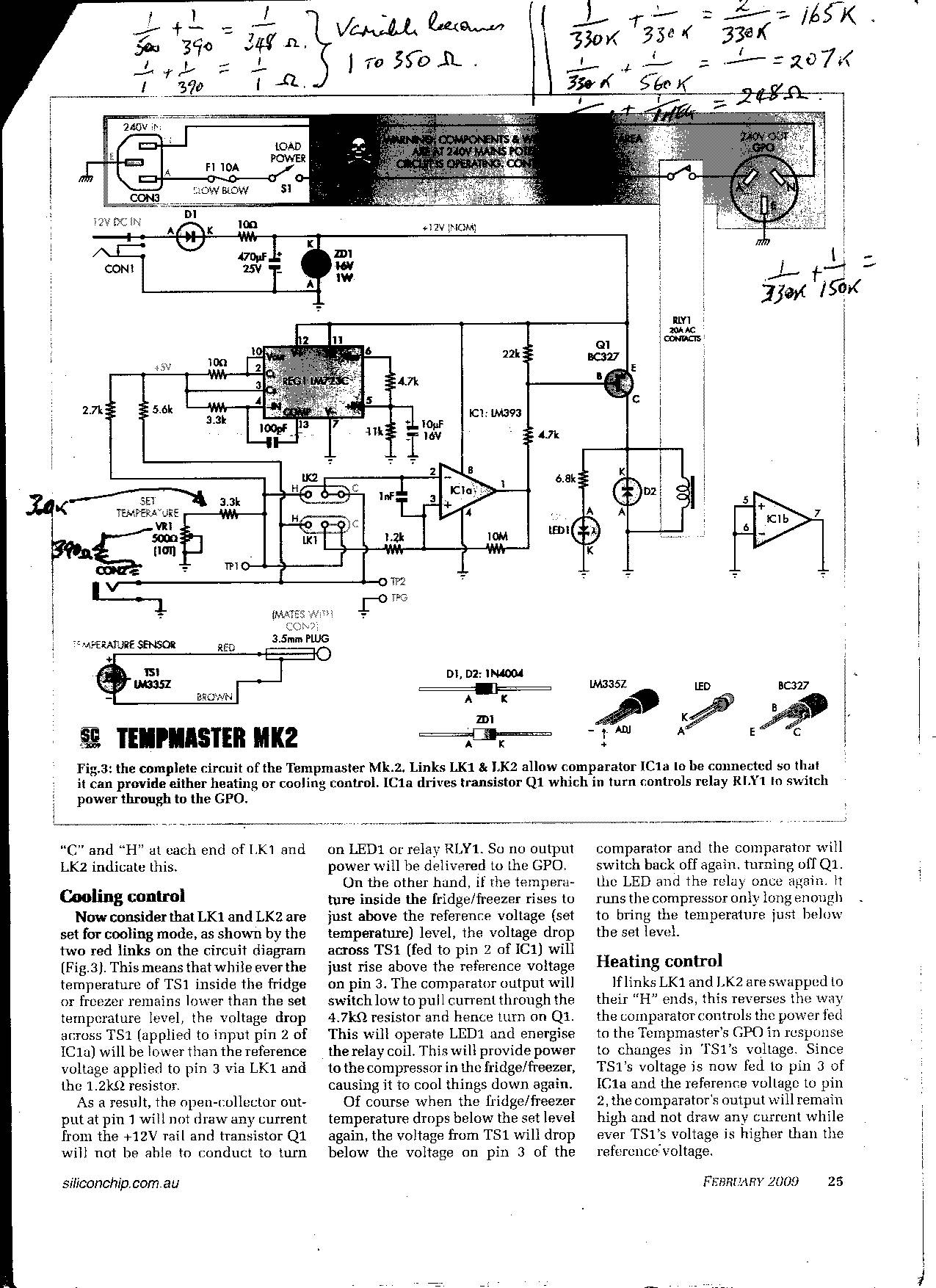

I need to be able to vary the cut in point of a temperature controller ,the LM335Z
The voltage drop on this sensor is 2.67v at -6C linearly to 2.75v at 2C.
Thats 0.01v per 1 degree C.
The kit is made with comparitor resistor values to give a range of 2 C to 19 C for cooling .
I would like to adjust that to say -10C to +6C

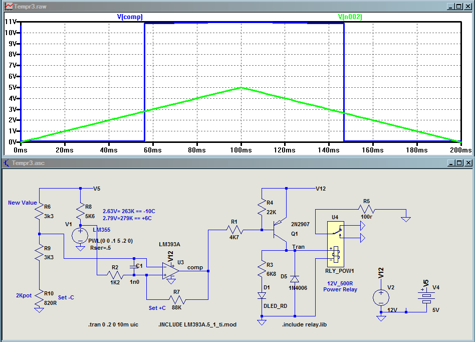

Look at this LTS sim of the modified circuit. [ignore the relay part]
The delta was using the -40C for the reference, I know it 0mV at 273K.:)
This gives 2.63V [-10C] and 2.79 [+6c]
Hope you follow it OK.

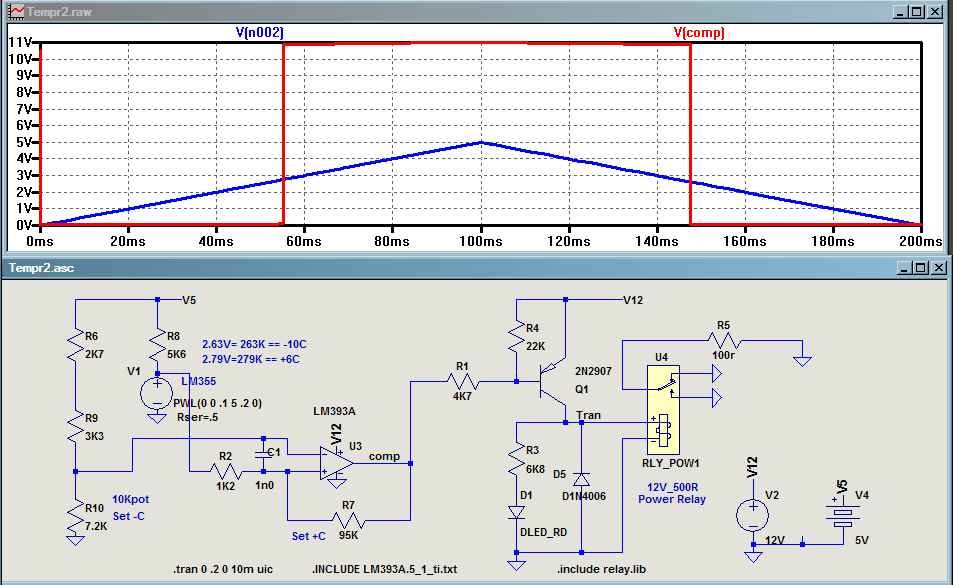

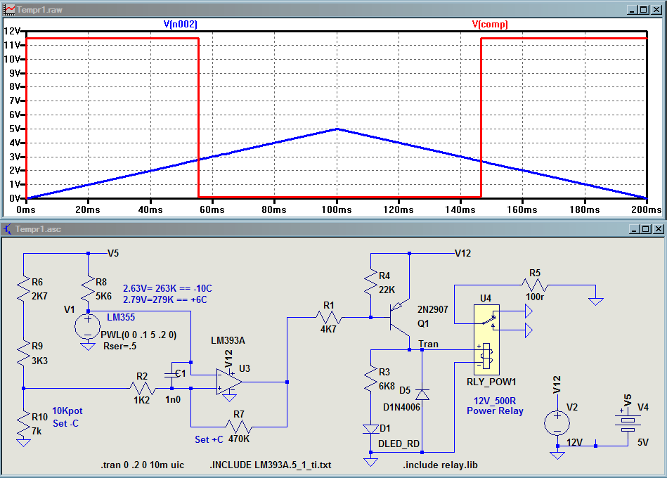

If you need to have the comp to switch in the opposite sense, use this circuit.
Changes are: swop the LM393 inputs over and reduce the hysteresis resistor [R7] to approx 97K.
I would use a 82K resistor and a 50K pot in series, this will enable adjustment of the switching limits.
On the first circuit a 430K and 200Kpot would allow adjustment.
Eric is this supposed to be the original circuit or is it something else ?
In both the circuits you have the comparitor + feed coming off after the 3.3k resistor. This is not the case ,it comes off before
What is the significance of the time graph?
I can see the voltages at which the comparitor switches off and on but what do the Ms mean.
I am trying to make sense of this -I know its probably me ! I have downloaded LTSpice IV which is freeware and am trying to make it work.
Can I copy this .gif file somehow or can you post the .asc file so I may import it ?
See attached the two *.asc files, you will need to get the LM393A and Relay models from the LTSpice Yahoo site.
I can easily change the take off point to the other side of the 3K3 if you prefer.?
I'll change it for you and repost.:)
The graphs show in voltage/temperature [LM355] the ON/OFF tempr of the circuits, in both senses of the LM393.
The mS is just the time base for the LTS sim run.

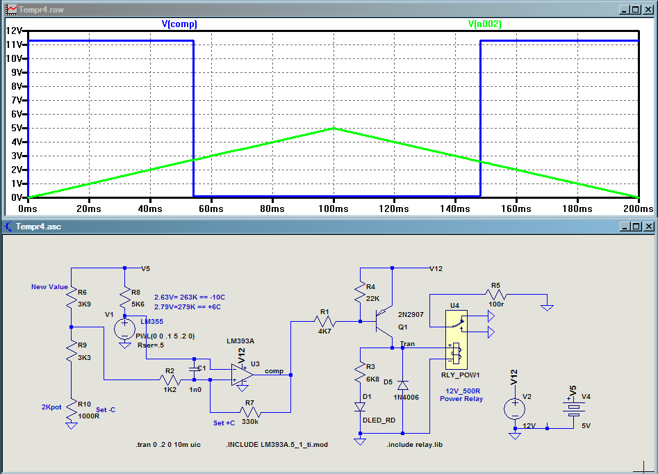

Look at these images.

Well Eric I got some files from yahoo although the DLED_RD and the 1N4006 I could not find and the simulation complained that it needed them so on my circuit I changed them to something it had .
See attached
But now from here how do I get it to show me when it switches on and off?
I can measure voltages etc and they show on the graph but can I get a meter circuit so I can attach a meter at various points and watch the voltage change as I change values?
  • MyTempmaster.asc
