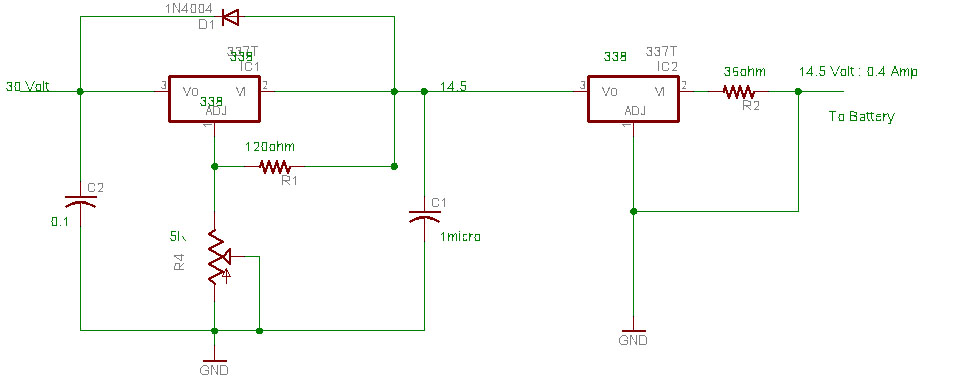

i have made this schematic ...... please look at it and tell me if i have something wrong .
i think it will provide 14.5 volt with constant Amp 0.4,
thank you

An LM317, LM338 or LM350 can be a voltage regulator or a current regulator.
You tried to combine the functions so it is a very poor voltage regulator and a very poor current regulator.
You need to have a current regulator in series with a voltage regulator for them to work properly.
The 30V input is way too high. It will just make a lot of heat in the regulator.
The current regulator should come first, because it needs up to 3.75V across it from in to out for it to work.
The 35 ohms resistor in the current regulator is incorrect. It should be 3.125 ohms for 400mA.
The 5k pot in the voltage regulator will make an output voltage of 27V when it is turned to half. A 1.5k pot will make 16.9V max.
speakerguy79 said:
Delete the ground connection to the adjust pin on the current regulator. That is where you connect your load.
could you please tell me how you calculate this resistor :
i have output volt of 14.5
I = V/R
I= 14.5 / 35 then I = 0.4 A
what is wrong in that

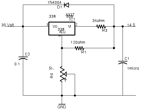

what about this ?
but where to connect the Gnd in the first Regulator.....or ir's not required

The LM338 current regulator has up to 1.25V from its OUT pin to its ADJ pin.
If you want a current regulator to have a 400mA output then the resistor is 1.25V/400mA= 3.125 ohms.
The LM338 current regulator doesn't connect to ground.
what will happen if i didn't use 1 watt for the resistor , may be i cannot find this value........will it burn the regulator
A 3.125 ohms resistor with 400mA in it dissipates 1.25V x 400mA= 0.5W. A half-watt resistor would be extremely hot and would burn you and other things that touch it. A 1W resistor is bigger and would be cooler.
Nobody makes a 3.125 ohms resistor. You simply parallel a couple or a few standard value resistors to make one.
