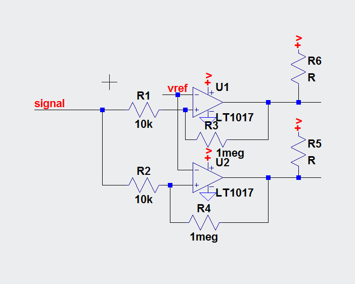

You require some positive feedback from the output to the non inverting input, its called hysteresis, try a 1megohm initially, lower if required

If you have more than one LM339 non inverting input connected to the source signal, you should have at least a 10K resistor in series with each LM339 input.
OK.?
EDIT: the 10k's will also protect the LM339 from a negative swing.

hi Dan,
The oscillation that you describe is a very common problem with comparators.
They usually occur at close to the Vref point.
Some users add small value capacitors across the inv/non invert pins, say 1n0 or 2n2
Do you mean a single capacitor between (-) and (+) pins?
Or from (+) to GND and from (-) to GND?
A single cap between pins + and - inputs.

The erratic behavior may be from the negative input current when the input goes below ground (see Note 3 in the data sheet). Thus you need a diode, or sufficient resistance in the input circuit, as Eric noted, to minimize this negative current.

It would be helpful if you were to post a schematic of the circuit as constructed and the method of construction (PCB, perfboard, breadboard, etc.). A lack of sufficient hysteresis and an excess of noise will cause the problem you have described.
They have a 100k pullup to +12V (maybe this pullup is too big?) and then driving a CMOS flipflop 4027
Hi dan.
A typical value for the output resistor is in the order of 3k9 thru 10k.
Try to have at least 1mA to 2mA flowing thru the resistor when the output is low.
I would also add a 47uF thru 100uF across the +V supply and 0V, in parallel with the existing100nF
