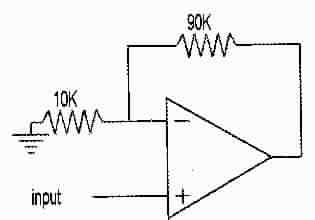

Can you tell me how to do this: LM34 output is 10 millivolt per deg. F. So at 75 degrees the output is 750 millivolt or .75 volt. I would like a way of amplifing the output so that it would be 7.5 volts at 75 degrees. How do I do this?
Use this amp:
