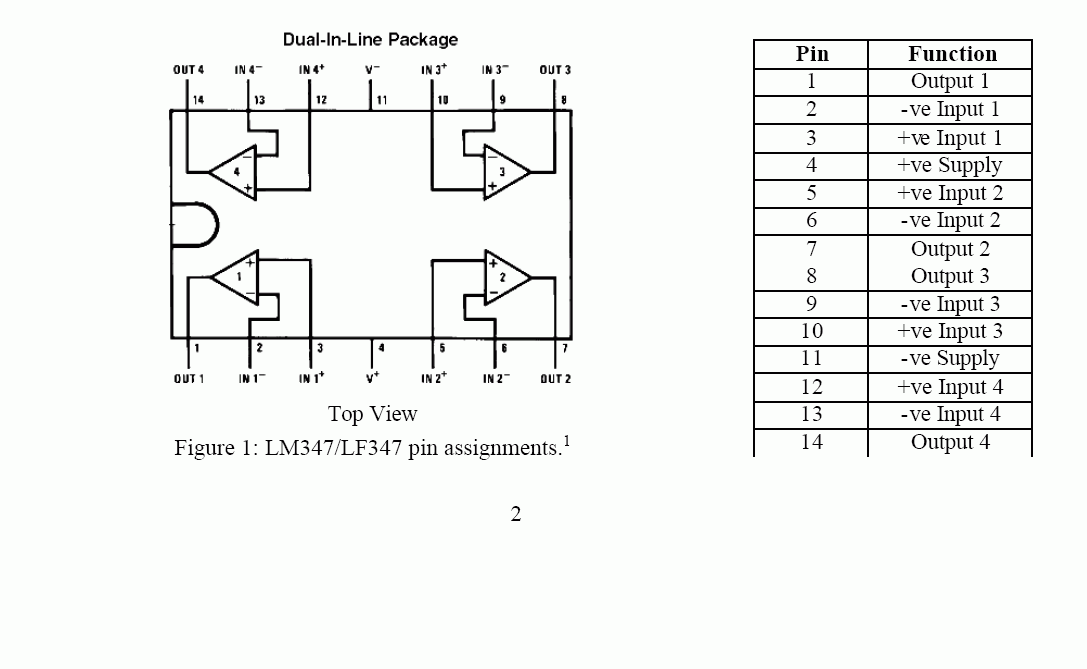

Can anyone send me LM347 comparator/op-amp datasheet from national semiconductor or provide me more details?
i had search over google but i can find this. It seem like discontinue item.
I don't recall National ever making an LM347. Where did you get this number? Perhaps it is a typographical error.
It is the same.
http://www.ee.latrobe.edu.au/~gt/ele21lin/ELE21LIN-Lab-2.pdf#search='LM347'

hotwaterwizard said:
It is the same.
LM347 is the same as LF347? I don't think so. Can you find a datasheet for LM347?
Nope Just Proof they are the same.
Search Results:
LM347 = TL074CN

I found this.
Good sleuthing, John.
In the National LF147 datasheet you posted, I saw one reference to LM147 for a specific ceramic-packaged part. You found enough other references to convince me that one or more companies produced parts labeled LM347. It's curious that none of them apparently produced a datasheet under that part number.
