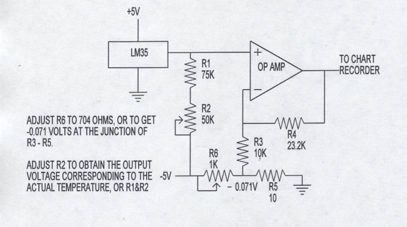

This circuit will do the job:
Hmm, part of the picture was clipped. R1 and R2 can be replaced with 100K if accuracy is not important.
I make the gain 1/400mV = 2.5 so R4 = 15K, and Voffset = 83mV
Adjusting R2 will have little effect.

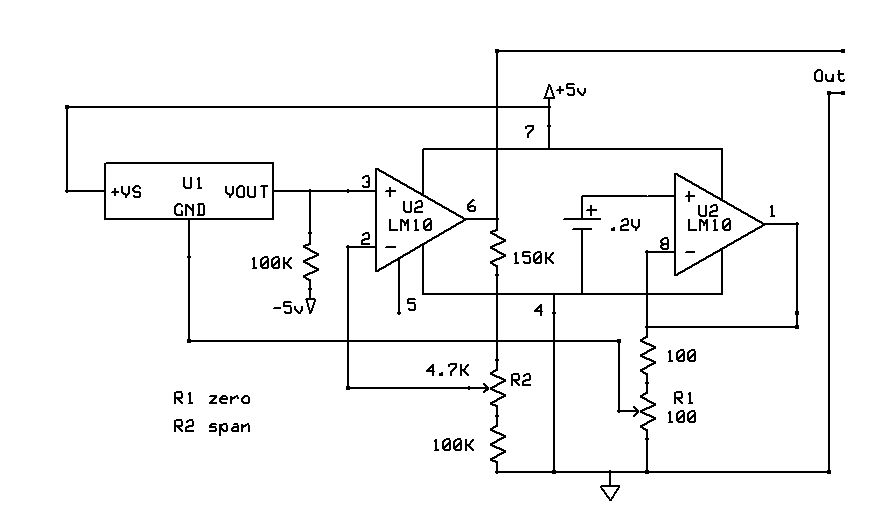

It's capable of putting out 1mA with little change in output voltage, ignoring selfheating. Here is an LM10 circiut. It does not require closely regulated supplies.
