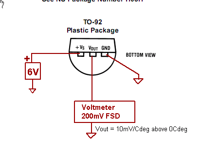

Try this, post what you measure.
You just set it up as shown in that link. Pos and Neg to any voltage 4.5 to 9v DC and the middle leg to your Volt meter red lead on the 2v DC range and the black lead to the voltage negative.
Have just done that on my LM35 and the meter reads 0.236v which = 23.6deg C. The display is stable, but if you have the bare sensor in a cool draught it may just move up and down.
If you still get 0.005v then supsect its connected wrong or damaged.
It is showing .009V
If you have connected it up as that Embedded link or Erics picture then you should be getting a sensible reading, as you are not , can only concluded the sensors duff, you need to get a new one.
( just reversing the + and - connections for a split second are enough to blow them)
There is a chance it is working fine, if you are testing it in a freezer where the temp is 0c ..:joyful:
