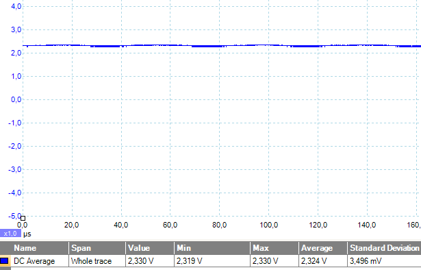

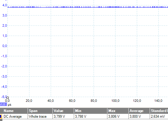

I'm aware that I don't know much about all this .. but this should be as simple as ohm law and it's driving me crazy ...
LM358N ..
pin4 (power -): gnd
pin8 (power +): +5V
pin2 (-): +2.32V
pin3 (+): +550mV
what should be the pin1 (out) ??? from what I know, as + is lower then - .. it should be 0V .. right?? ... well .. it is 4V ?!?!?!?!
OSC output attached for all three pins ... is there anyone that can shed some light before I give up on this completely
EDIT: no feedback .. pin2 is connected to voltage divider (1 resistor to ground, another resistor to vcc), pin3 is "signal in" and pin3 is connected to osc via resistor

Put a 10K resistor to ground on your input pin.
You forgot to attach a schematic so should we guess?:
1) Is the +5V supply a low resistance?
2) What is the resistance of the load?
3) Does the load connect to +5V?
You show an output from +1V with a lot of ripple. Why doesn't it go down to ground? Why does it have so much ripple? Its high of +3.8V is normal.

Before you had a problem with DC and extremely low frequency signals.
Now you have an LM833 signal generator working from a 5V supply when its datasheet shows a minimum supply of 10V.
The lousy old LM358 has PNP input transistors that need a resistor to ground because the input current is positive. The input of the LM358 in your circuit does not have a resistor to ground so the input floats to a higher voltage.
A 100k resistor to ground at the input will have a voltage caused by input current of from 4.5mV to 25mV.

Since the input transistors are PNP then their input bias current pulls the pin 3 input high without a resistance to ground. When you measure the voltage at pin 3 then the resistance of your voltmeter pulls the voltage down but without a resistor to ground then pin 3 is high which causes the output to be high.
