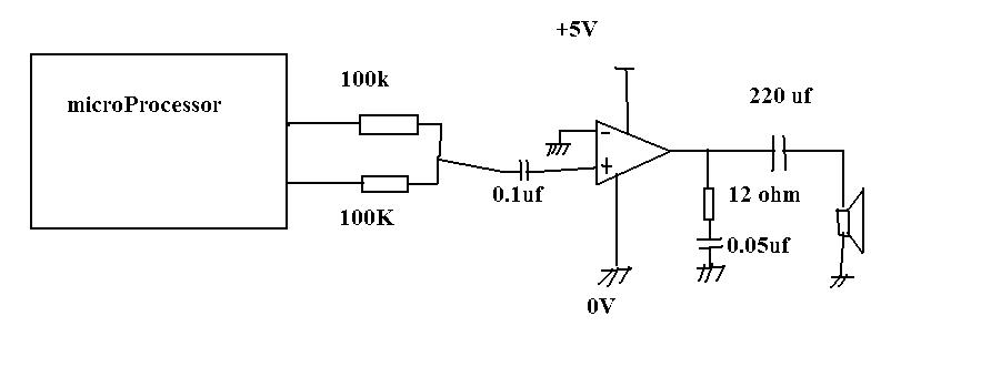

The LM386 seemed to did its job when I connected according to the datasheet. However, when mixing two channels, (both square waves, enveloped with decay) the other channel is distorted.
I could have did something wrong during the mixing. Is there any extra procedures I should follow when mixing two different channels?
You forgot to attach the schematic of your mixer circuit and the impedances of the signals.
Sorry for the inconvenience. Here's the schematic in the attachment. Pins 1,7,8 are not connected, and from the microprocessor, two enveloped square waves are outputted to the non-inverting input of the LM386.
Edit: Again, I borrowed the design from the site - this time it wasn't about the envelope filter, but apparently they did mix the signals well in the amplifier: **broken link removed**

The LM386 amplifier has a voltage gain of 20. Its output at clipping is 3V peak-to-peak when its supply is only 5V. Then its max input is only 3V/20= 0.15V peak-to-peak at clipping.
The input resistance of the LM386 is typically 50k ohms so the two 100k mixing resistors feed it as an attenuator. Then the max combined input is 0.3V peak-to-peak before clipping distortion. Maybe your input signal is higher.
I am glad to see that you added the important resistor and capacitor at the output of the LM386. It also needs a supply bypass capacitor, 10uF to 100uF.
that bypass cap should be DIRECTLY from pin 6 to pin 4, with the cap leads as short as possible.
i have used LM386 chips on a breadboard before, and it will work, but on a breadboard, the bypassing, andthe zobel network (the resistor and cap on the output to ground) must have as short wiring as you can manage. and keep the speaker wiring far away from the input wiring.
