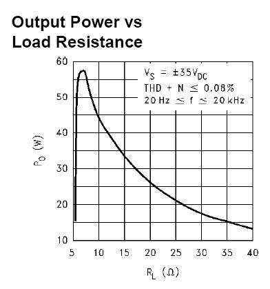

why the PDF of the LM3875 says only for 8 ohm? it can't handle well 4 ohm speakers? i haven't noticed something bad all these days i'm using my amp...and i think it should deliver more power as we reduce impedance...

it seems lm3875 can't drive 4 ohm loads and i think its because of the internal curent limiter build as a protection.
as for the speakers u can put them in series but if u can put the woofers in series and the tweeters in the same box and use a proper crossover u will fell the difference.

the internal protection circuitry limits the current draw and the IC outputs less
watt?
All this time i was working it with 4ohm load...this means that i haven't see the real output of the IC?
i have this crossover can i use it with my 4 ohm speakers?
yes as u can see from the chart the power output drops seriously when the load is under 6 ohm or so...

Ι don't understand...i think is shows a rapid fall under 8ohm and from the other side it is more linear as we increase speaker impedance...is that exactly what happens?

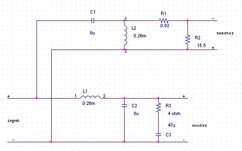

i couldnt find the freq response curves so im quite blind but i came up with something very minimalistic but it should work better than the other one. the cut point is at 3.5 kHz 2nd order Butterworth, that means there will be a 3 db boost at 3.5kHz which compensates for the natural rolloff of the drivers (if it is there :) ). Use capacitors rated at least 250V and at temperatures preferably higher than 85 degrees Celsius and try not to use electrolits.
If u plan on a bigger upgrade i suggest using a midrange like GDM10/60/2.
Take care.
i was about to upload the frequency response diagram...but you said that your're going to find it... :D
anyway...the schematic you send me is calculated to pair my 4 ohm speakers with my LM3875? i see it's in parallel that why i ask... :rolleyes:
i don't have a way to know how to wind the coils so i can have the mH you specified...is it possible to translate it to wire dimensions? :D :D
upload the charts if u have them
the tweeter is in parallel with the woofer the ideea was to put to boxes (containing a woofer and a tw each) in series but its a bad practice.
if i would have made a series xover the resulting impandance would still be 4 ohms

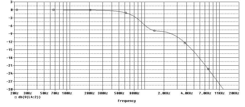

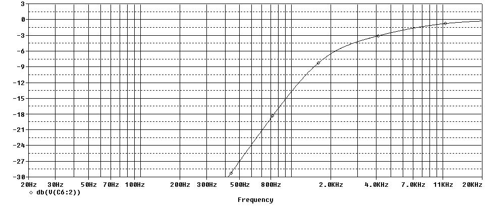

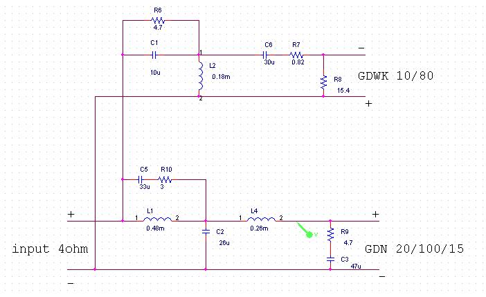

ok as i promised here is the xover. the inductors can be build after this calculator https://www.lalena.com/Audio/Calculator/Inductor/ the spl of the tweeter is 2dB higher than of the woofer so i attenuated a bit also there is an attenuation in the mid region to compensate the woofer's natural rise in spl. use this with 4 ohm amps if still want to use ur LM than i sugest u take the speakers put them in series (woofer+woofer, tw+tw) and make a new box for them... and a new xover if that is ur plan let me now so i can modify this xover for 8 ohm.
