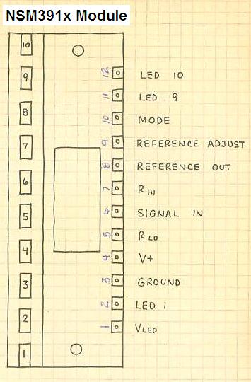

About 45 years ago I made a 60dB audio level meter with two LM3915 "modules" that were made by National Semiconductor.
Each module has a small pcb with the IC covered in a black blob of epoxy and has an LED strip already connected.

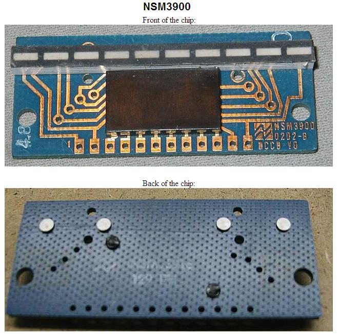

Here are the NSM3900 modules made by National Semiconductor that I bought in the 60ies. They had an LM3915 surface-mounted and a surface-mounted strip of 10 red LEDs.
Today, the LM3915 and LM3916 are not made anymore and the LM3914 is available only in a tiny surface-mount package.
