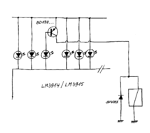

I'm using this IC to measure batt voltage and drive LEDS...success
Does anyone know how I can switch a relay on when one of the LEDs are
lit?
thanks
Alex

Alex[/Which ever LED you want to operate your relay_ connect one end of a 1k resistor to it's cathode, the other end to a PNP type transistor_say BC212 etc general pupose. Connect the emitter to the +v the collector two one side of your relay coil. Connect the other side to ground -V. Connect a diode say 1N4001 etc across the relay coil. Anode side to -V /circuit ground. Note supply voltage for relay coil? I haven't tried circuit with LM3914 but should work OK. Note none latching.]
Hi Alex,
If you want to drive a relay you'll need a saturated switch,
therefore you'll need more base current than in (normal) linear
operation. The base current to drive your transistor won't flow
through the led which means that this led will be less bright than
the other's. So save yourself a resistor and connect the base
emitter junction of the transistor in series with the led.
on1aag.

I believe your idea will not work, as the collector current is equal to the emitter current - the base current. The LED current is limited by the circuit of the LM3914 and that will be the maximum emitter current.

Did you forget that most transistors have beta >> 1?
Brain fart, maybe?

After reconsidering my answer, Rolf is right it....... was a brain fart. The only thing the LM3914 is going to do is limit the base current.
