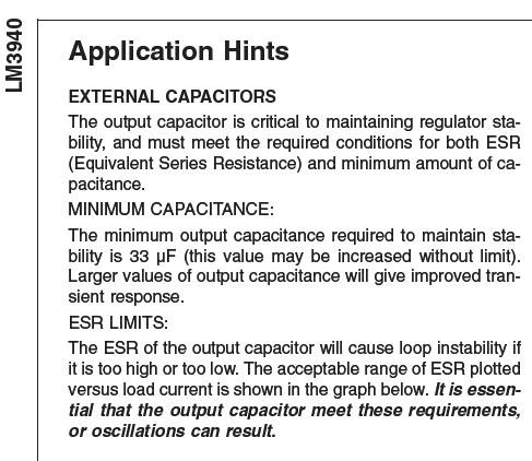

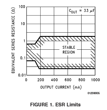

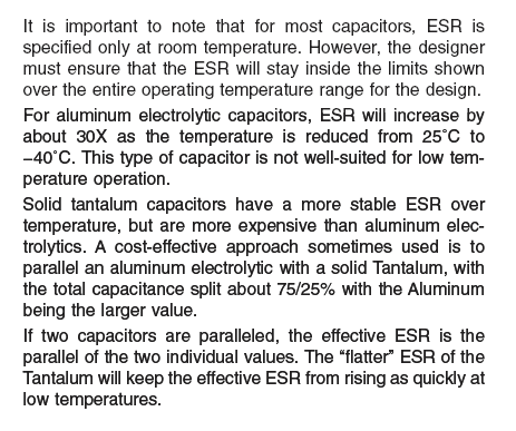

The LM7805 and the LM3940 are completely different animals, and their capacitor requirements are quite different.
You can use any value of output capacitance on the LM3940 so long as it is 33uF or more. The attachments below are out of the datasheet. I am posting them so you will know where the information came from.

That capacitance can be increased. The critical parameter is the ESR of the capacitor. The better choice is a tantalum capacitor because of its lower and more stable ESR.
