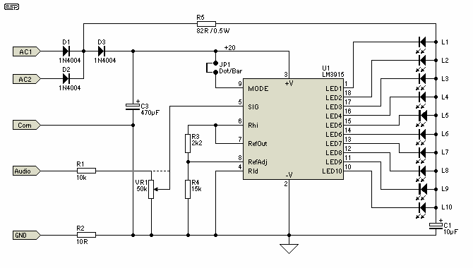

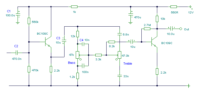

well, I would like to make an audio amplifier that features:
  • high quality, low noise sound
  • dual mic inputs, plus normal stereo input as well
  • the ability to mix the above chanels (with pots)
  • high power (10W would be awesome)
and so I would like to try National's LM4766 Stereo amp. I want to combine a variety of different circuit ideas to get the result i desire. I have attached all that I feel is neccessary. It would be fantastic if someone could help me, review the circuit ideas (not mine, btw) or suggest a different system.
*note: will have two VU meters and tone control preamps (one per chanel)
THANKS!!

Sorry, but that preamp is really crappy! - an emitter follower input stage (to give a highish input impedance and no gain - WHY?), a passive tone control (to give a huge loss), followed by a little amplifier (gain of about 5 times). You're making a considerable loss through it, no gain at all.
What are you wanting to feed it from?, it looks fairly useless?.
I would suggest dumping the transistors, and using some opamps!.
mike11298 said:
yeah, i was thinking op-amps, but dont they create a bit of noise? how can i get my tone controls?
No, audio quality opamps are nice and quiet, every CD in your collection has almost certainly been though hundreds (if not thousands) of them.
You use active tone controls, in the feedback loop of an opamp - it's the standard way to do it, and has been for many decades.
You appear to be wanting to make a small mixer/amp?, what's it for?.
Do a search for "Baxandall tone control schematic".

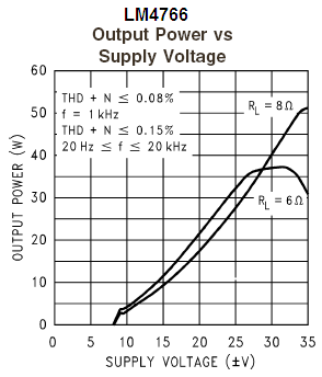

The datasheet for the LM4766 power amp IC shows an output of only 3w per channel into 8 ohms with a 20V supply.
The VU meter will be a dim blur unless it has a Peak-Detector as shown in the datasheet for the LM3915. Use an LM3915 instead of an LM3916 then each LED is indicating double the power of the preceding LED.
does it? where? with my calculations (hmm) it would be 'round about 13W per chanel for 24v (suply i'd like to use) and 11W per chanel for 20v. even +- inaccuracies, its still fairly ok.
Also, i intend to use LM3915, as its the only one readily availiable to me.
The datasheet has a graph of power output vs supply voltage. To an 8 ohm speaker the power is 25W with a dual 24V supply and is 17.5W with a dual 20V supply. Your schematic showed only a single +20V supply.

oh ok, well I have a 6 ohm speaker, but when the graph says "24v", is it refering to a +12v, -12v supply or +24v, -24v supply?
Also, is there a ay I can change speaker impendance for better performance? (adding a resistor just doesnt seem right :)
EDIT: ... and do I need a split power suply? why can't it just be single supply. Also, there was a schematic in the datasheet for a single supply. Is that OK?
The bottom of the graph is labelled "Supply Voltage (+/-)V". The graph shows that a +/-24V supply (48V total) allows 30W into a 6 ohm speaker when the distortion is low. You can calculate that the voltage across a 6 ohm load is 38V p-p. So the amplifier has a 10V loss.

The posted graph has "(+/-V)", right after the words "SUPPLY VOLTAGE", in the horizontal axis label. So it does mean both + *AND* - 24 volts, i.e. a dual or "split" power supply. A +/-24v split supply is equivalent to a 48v single supply.
Also, your original 20v single supply would be worrisome. The datasheet shows 20v as the absolute minimum guaranteed-to-work difference between the supply rails. Plus, it would only give you about 3 Watts per channel.
See page 16 of the LM4766 datasheet, at **broken link removed** . It says "The typical application of the LM4766 is a split supply amplifier."
You CAN use it in single-supply mode. But it's a little more complicated, and might even compromise the sound quality, slightly, by necessitating electrolytic input and output AC-coupling/DC-blocking capacitors.
But yes, the single-supply schematic, in the datasheet, should be perfectly fine (especially if you have a 48v to 52v supply).
