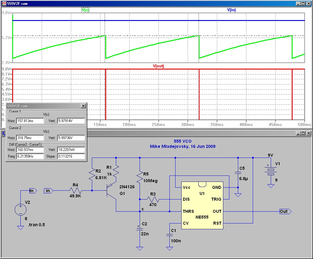

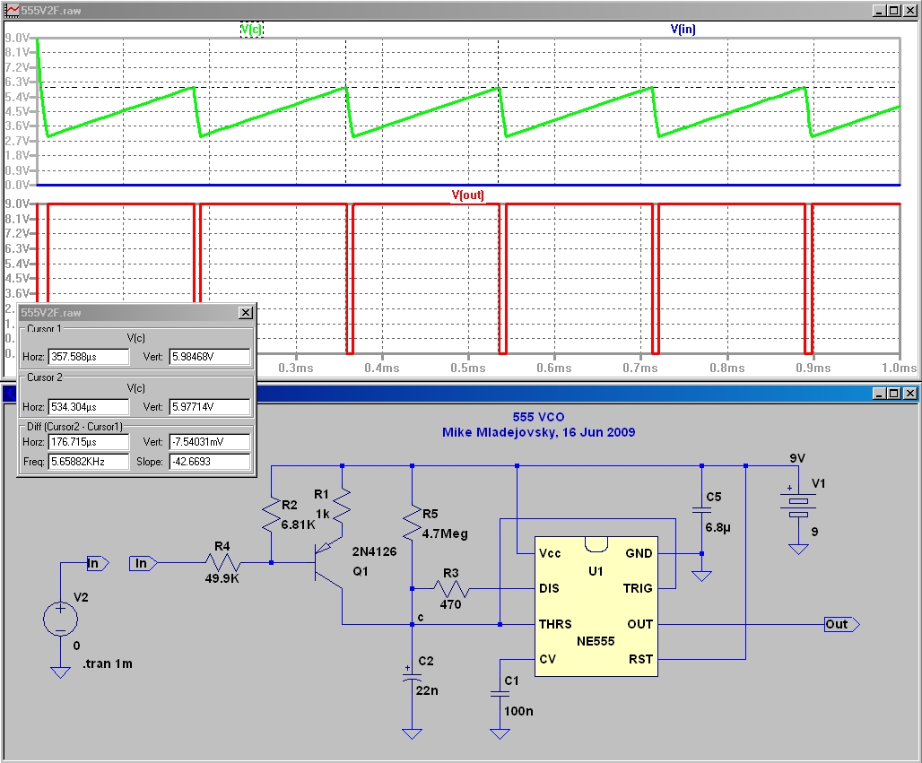

Also, it is possible to build a voltage-controlled current-source, which in turn drives the timing capacitor in the 555 astable, which does give a reasonable F vs V curve.
I attached a sim of the 555 driven from a current source. I played with the values to get 5KHz and about 5Hz as the control input goes from 0 to 8V. If you change the supply voltage, you will have to re-optimize the other resistor values. Temperature stability will not be very good.
