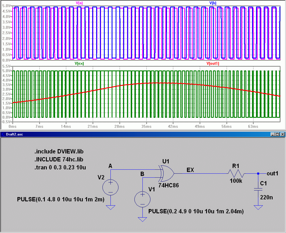

Look at this
about the XOR gate with low pass filter

Look at my sim again. The varying phase is simulated by having the frequency of the A signal slightly different than the B signal. Note the PWM output at output of the XOR. Note the "averaged" output at Out1.
The RC time constant of the low-pass needs to balance "ripple" output vs how rapidly the phase of the two inputs can change. In a PLL, the filter output cannot have hardly any ripple, so an aggressive low-pass is used. For most applications, the low-pass filter is usually implemented as a multiple-pole active filter, such as a unity-gain Butterworth Sallen-Key filter.
