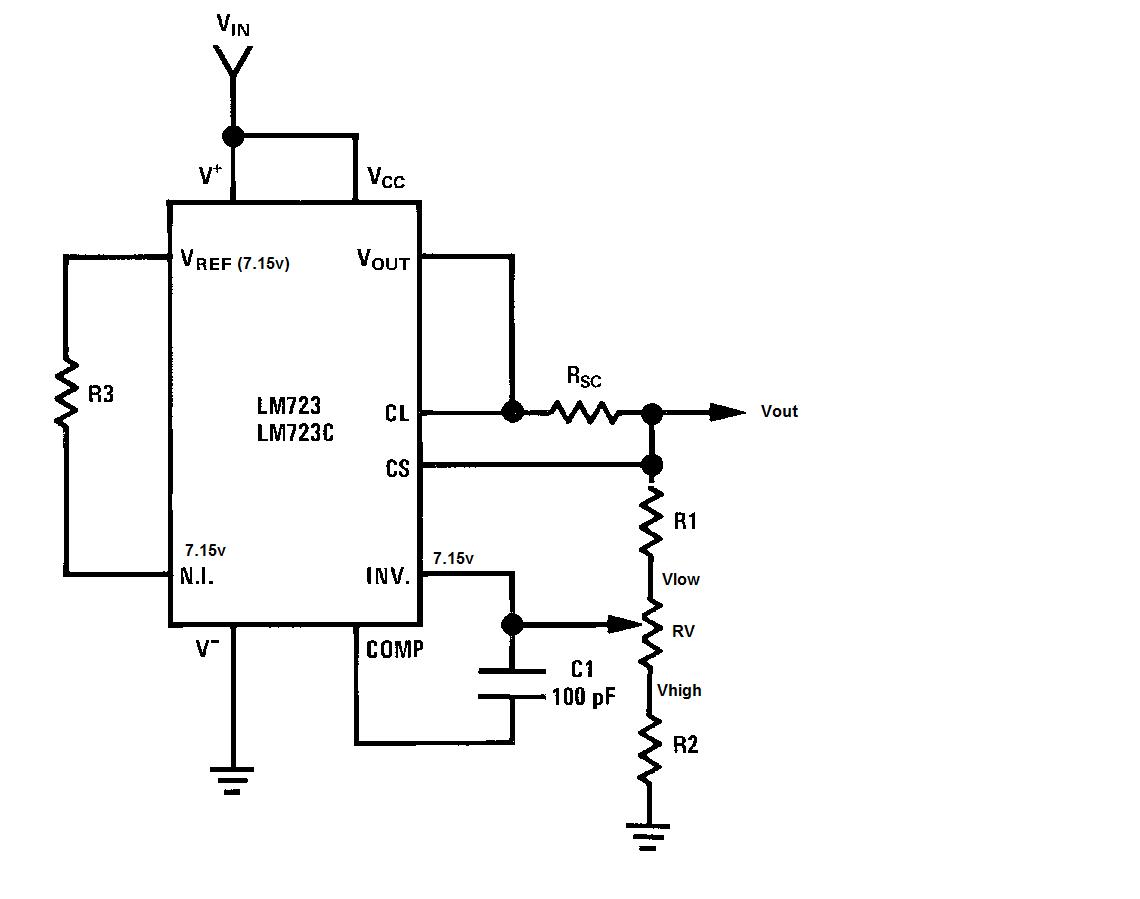

Then I'd like to regulate this voltage thanks to the LM723 between 10 and 20V under a max current of 100mA. I'm using a the basic high voltage regulator circuit that I found in the datasheet (figure 2 : output between 7 and 37V) :https://www.electro-tech-online.com/custompdfs/2010/03/LM723PDF.pdf

For a variable output with definable upper and lower limits, you will need to have a potential divider with three resistors R1 R2 and RV.
RV being the pot used to adjust the output voltage.
The reference voltage of a 723 is 7.15 volts. (It does have a tolerance, see the datasheet).
When the 723 is operating normally and correctly as per the circuit, the voltage at the INV pin will be 7.15 volts.
When we adjust the pot (RV) to the R1 end to get 10 volts output, Vlow will be 7.15 volts. (Vout divided down by R1, RV+R2).
When we adjust the pot (RV) to the R2 end to get 20 volts output, Vhigh will be 7.15 volts. (Vout divided down by R1+RV, R2).
From this we can make a couple of equations.
R2 = ((Vlow/Vhigh) x RV)/(1 - (Vlow/Vhigh))
R1 = ((Vhigh x R2) - (7.15 x (RV + R2)))/7.15
Now:
Select a value for RV, I suggest 1k ohm.
Calculate the value of R2
Calculate the value of R1
Build and test the circuit.
Simple!

I calculated the values of R1 and R2 and found 797.2 and 1kohm (potentiometer = 1kohm). So I'll take 820ohm for the value of R1.
For the current limit, I'll choose Rsc=6.8ohm wich gives me a Iout of 0.09 A (90mA).
Then I'll connect these components so as to build a high voltage comparator circuit.
Am I right, so far ?
Thank you.
Hello,
They look like the values I calculated.
If you use 820 ohms for R2, the output will not quite reach 20volts.
You may want to put another resistor in parallel with the 820 ohm to give something nearer to 797 ohm.

Here is the circuit I built on Pspice : R1=797ohm, R2=1kohm, RV potentiometer set to 1kohm in this case and R3=R1//R2, Rsc=6ohm for current limiting.
My voltage source is an AC source with Vampl=25V which should be enough to reach a Vout of 20V (markers V+ and V-).
With these settings, I should get an exact Vout of 20V.
Nevertheless, my Vout is never higher than 13.5V (even if I have a 35V source or different resistors values).
Does the problem come from Pspice or is my circuit wrong ?
I observe that if I set the settings well to get a Vout of 10V, I get it.
Thanks for your help.
...my Vout is never higher than 13.5V (even if I have a 35V source or different resistors values).
Who knows? Never mind playing computer games, get the soldering iron out and burn your fingers on real components.;)
Yes it is, have a good look at the circuits in the datasheet and then remove the connection from pin 9 (Vz).
A real one will then work correctly, not sure what the computer game will do.

You are right. I modified a few things in the part properties to let the Vz connection float so I don't get an error.
Now, it's working properly and I get a voltage between 10V and 20V depending on the setting of the potentiometer.
