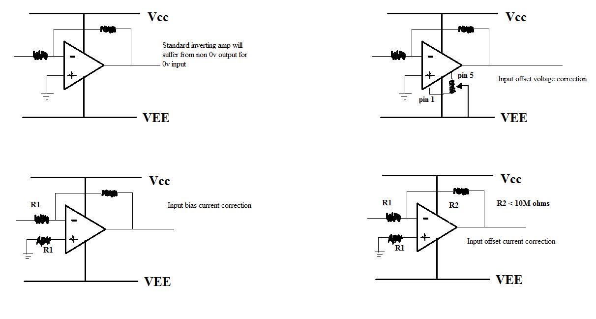

i am using 741 to amplifier my Vin in non inverting .But why i dint supply Vin to my circuit,there still got value for Vout???
the circuit just a very simple non inverting amplifier. i still face the problems when Vin=0,but Vout still got value?
From theory,when Vin=0,Vout also =0 rite??
If you have both positive and negative power supplies connected to the +V and -V pins respectively, and if you connect the input pin to ground (not floating), then your output should be very close to zero volts. If you haven't done both of these things, the the output will not be zero volts.i just wan to know,if i dint supply any Vin to my circuit,is that my vout will be zero???
R2= 220
R1=100
Vin=0
Vout=8v
