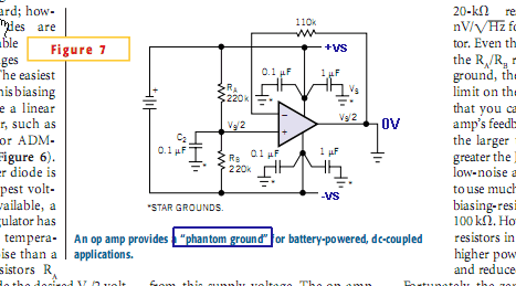

Look at this PDF for options on how to do this, ask if you cannot follow it.
Figure 7 in that document has the battery shortcircuited to ground.

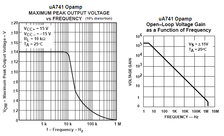

I'm making an Ultrasonic TxRx circuit,. My receiver part uses LM741 as signal amplifier for the output of the ultrasonic transducer,. Operating frequency is 40KHz,. as mentioned above the output of LM741 is just above 9Khz,. does that mean it is not applicable for my project??
As was said above, the lousy old 741 opamp is 43 years old and has almost no output at ultrasonic frequencies.
Use an audio opamp instead that performs well up to 100kHz. I use TL071 single, TL072 dual and TL074 quad audio opamps that are inexpensive and are available almost everywhere.
Here are two graphs from the datasheet of a uA741 opamp. An LM741 opamp is the same.
hi atferrari,
Look closely at the text description for fig #7...
Edit.
I have corrected the multiple 'gnds'
