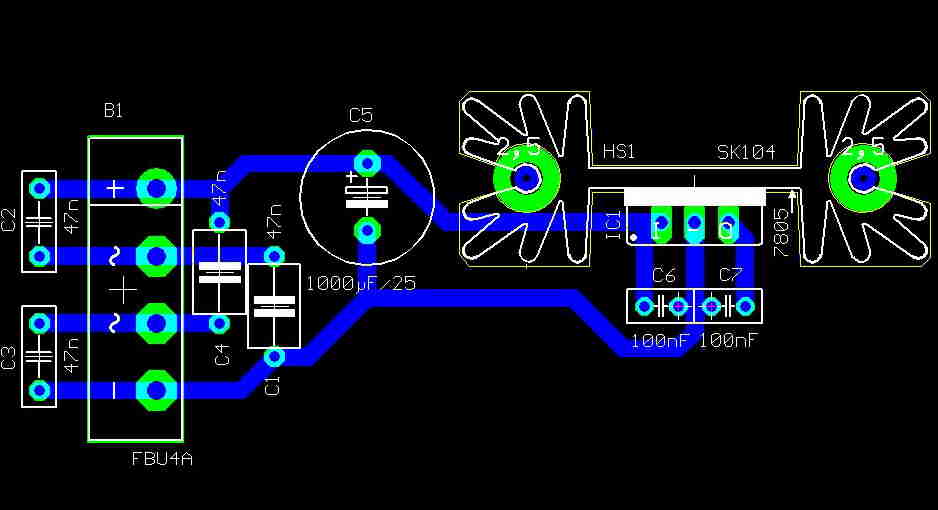

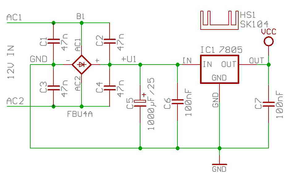

It is always good practice to use four 47nF capacitors across each pin of a bridge rectifier.
The 100nF capacitors should be as close as possible connected to the regulator IC.
Check the screenshots for details.
Boncuk
I've seen that before but I've never bothered using them.
They are an advantage in an environment where machines are running, such industrial areas, reducing spikes and RF riding on the AC to a great extend.
Using pin spaces of double the pin space of the rectifier AC in and DC out can be straight lines on the PCB layout.
Hans
I'm still not convinced.
The mains transformer will have a huge core loss at RF frequencies, therefore it should provide adequate suppression and a single 100nF ceramic capacitor on the output of the rectifier should remove any remaining RF.
Mains transformers will pass RF b/c of interwinding capacitance, so I think Boncuk is right. True isolation transformers take extra precautions to prevent this.
Small capacitors across rectifiers can reduce RF interference caused by diode switching. I see it mostly in receivers.
