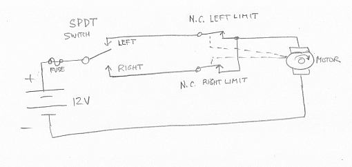

You need three switches. one is a Single Pole Double Throw toggle switch that is used to control where you want to the carriage to go. Two are Normally-Closed Single Pole limit-switches mounted such that the motor-driven carriage opens the switch when it reaches either the Left limit or the Right limit, respectively. The limit switches should be the kind that have an arm and roller, like this.
