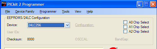

You need the stand alone PK2 software. You can download it from Microchip.
Yes - I have the software, but I'm at a lost here. What should I do next?
I tried making an ASM out of it from the MPLAB IDE, but it refuses to make me a HEX file.
Or should I type the HEX by myself? Is there any proper procedures for that?
Also, the PICKit 2 didn't detect the EEProm - or must I select it manually?
In the PK2 software you select device family EEPROM and then the actual device in the drop down box.
As to how you make a hex file, that depends on the data that will go into it. What do you intend putting in the EEPROM?

Just start a project with an 18 series chip (18F2620) and add an asm file containing,
	org	0
	db	1,2,3,4,5,6
	end
And it will make a hex file for you.
You must select a pic18 with at least as much memory as your EEPROM, the 18F4620 has 64k and so will do most EEPROMs. You can't select 16 series as they have 14 bit memory.
