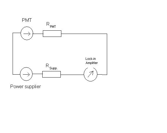

I'm working with photon multiplier (Hamamatsu R928) - detecting a light signal over the scanning sample. Because the signal is really low I want to add lock-in amplifier (Standford Research Systems SR830). Unfortunately the signal from PMT is about 3V (constant value) modulated with changes of light intensity due to changes in scanning sample's surface. The problem is that lock-in amplifier's input is only +-1V. I tried to get rid of that "background" voltage by using scheme below, but it didn't work (and also don't know why).
Have you tried using a series capacitor to block the dc?

I didn't want to use capacitor, since my mogulation signal changes sometimes not so fast, and then it would be also cut.
What's not so fast? The lock-in amp has an input resistance of 10Mohms so you can get a very low frequency response with reasonable sized capacitors. For example 1uF will give a time constant of 10 seconds and a low frequency cutoff of .016Hz.
