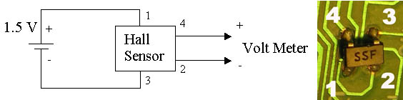

the schematic is what i used to make my gauss meter which is what the hall sensor really is .
i got it from a rc site
https://www.rcgroups.com/forums/showthread.php?t=307133

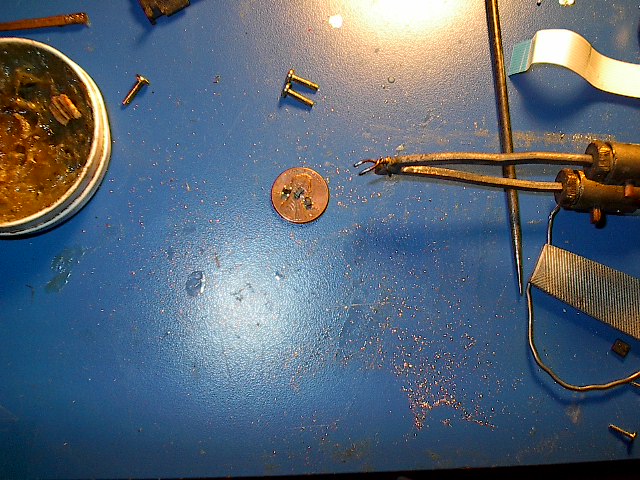

the second pic is the three hall sensors i got out of a cd drive , they are really really small .

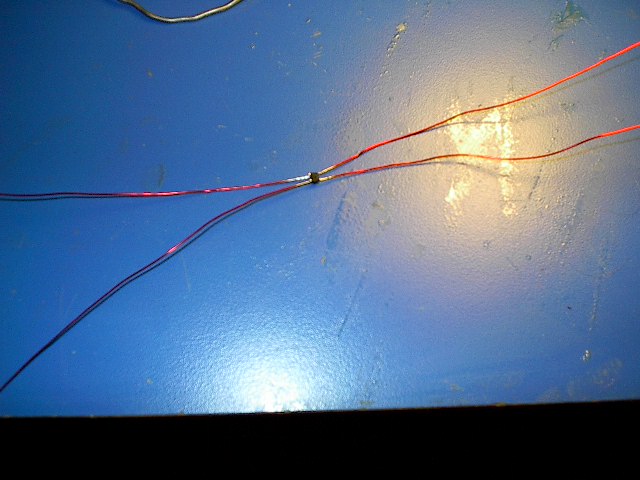

the third photo is it with the wires hooked on
since the hall sensor measures magnetic flux it can be used to measure ac current with a ferrite torriod with a slot cut in it and current under test flowing through a wire wrapped around the torroid.
the output of the sensor was .6V peak when i spun my magnets over and under it.
and about .4v peak whem i used the ferrite torroid to measure the current, i havnt calibrated it yet , and i dont know if the output voltage will vary with a different input voltage applied.

measuring force with hall sensor
I've got it!
the hall sensor can indicate the position of a magnet to the sensor
and F=kX is force on a spring
and
Knowing the force on the spring (by measurement ) for a given displacement
i can then measure a Force electronically .
