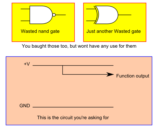

Ok. If you're sure solution is correct, you only need one nand gate and one xor gate because any inputs won't have no effect.

Na. Frankly you doesn't need a gate. A wire would work properly to this do the function. Spending a physical gate on that is just a big waste.
If you don't understand, I show:

As Grossel showed you, a wire is all you need, and that is just about as minimal as you can get.
