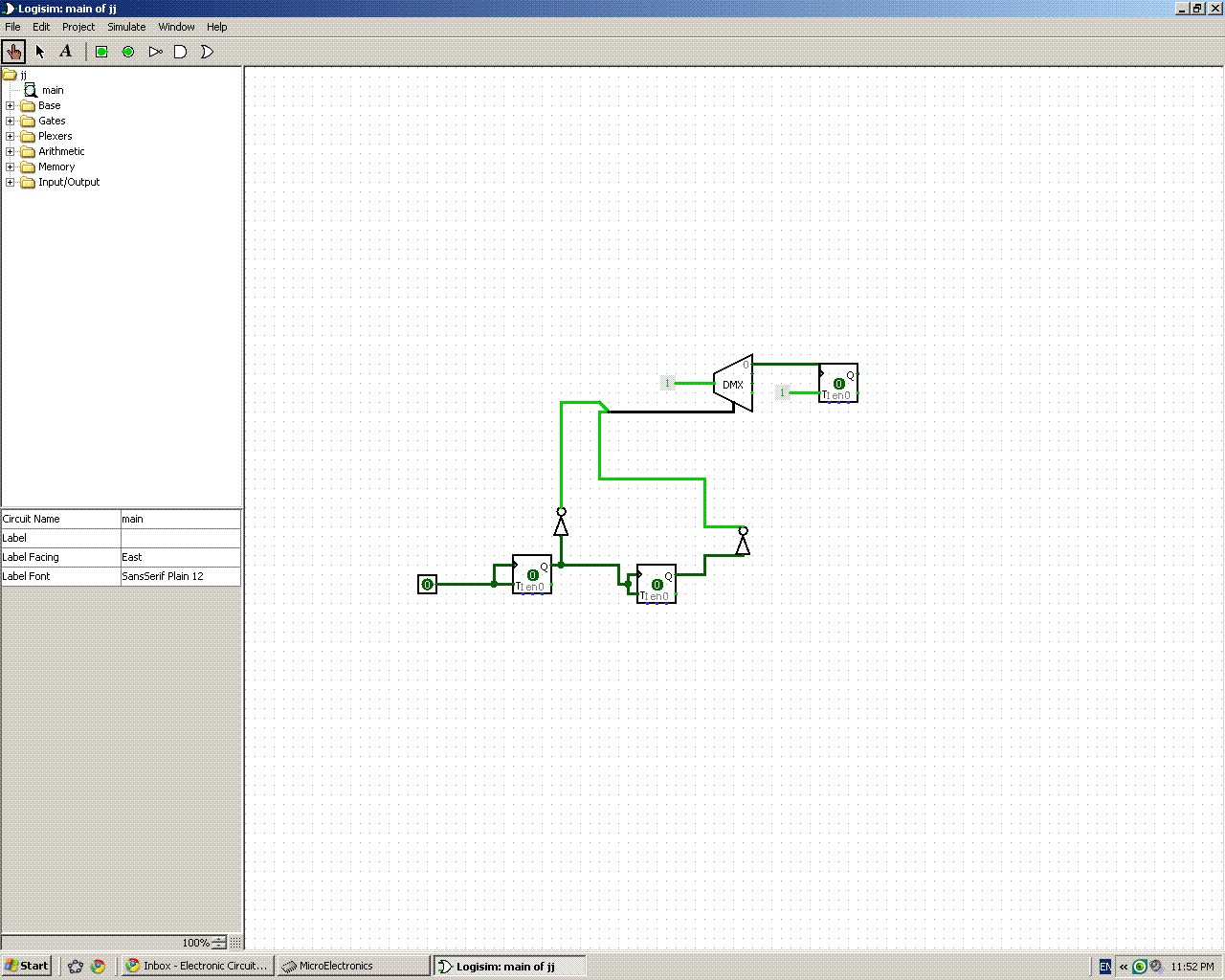

I have made it easier to see the problem please someone help me why does the flip-flop change D on DeMUX-s "three"? when demultiplexed bit is 3, flip-flop changes value. please download and check.

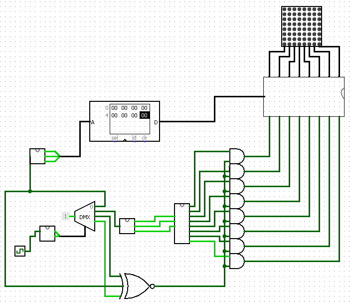

here if i press A, D will go to 0 and I dont have a clue why (the second picture is when I clicked on A)

I think that it's becouse of that:
when I click, firstly first latch changes and in picoseconds second, and while this picoseconds, 01 is being sent to Demux thats the reason. Am i right? how to correct this?
