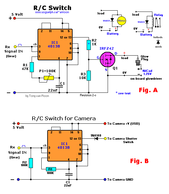

I have another question. The outputs on the receiver are for servos, but what if i wanted to simply say "on" or "off" (without hooking a servo up to a toggle switch), or what if i wanted to control something analog? Would i have to make something, or are there modules out there?

A simple on/off can be constructed from a microswitch with the servo arm actuating it. Most people I know have gone to electronic versions, however. Here are some references:
I have attached an image of the Guelph schematic. The Welwyn schematic is pdf and too big, but I have attached the explanation that downloads with it. It is really quite simple. You just set up your flip-flops to determine whether the pulse is longer or shorter than what you set the switch point to be.
Remember, the receiver does all of the decoding. If you have an oscilloscope, it is kind of fun to circuit trace the signals and see what the composite looks like when you wiggle the sticks. I have done that to show mixing to other fliers. Where the servos plug in, however, it is simply a single channel of PWM.
There is a variety of commercial switches made and many of the hobby sites have them. John
That is what i was trying to avoid, but it may come in handy when i first get it.
Oh, and thanks.
Ok. That schematic looks simple enough...
So the receiver actually consists of two separate parts? The radio decoder, and then the signal from the decoder is sent to the PWM circuit? So in theory, i could just intercept the signal from the decoder before it is sent to the PWM to control my own stuff, instead of just having a PWM output?
