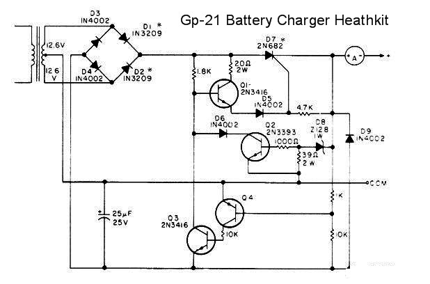

works great built one been in use 30 years.
it slowly discharges the battery slowly thru the 1k and 10k resistors though when the power is off.
I put a small relay in series with the amp meter to stop that.

I will be posting the schematic for the charger as soon as I find it...;)
