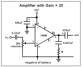

jigga what? what what could i use as a battery
The TDA2003 amplifier IC is designed to drive a 2 ohm or 4 ohm car speaker from a 12V car battery.
For your dinky little "speakers" you might as well use a dinky little TDA2822 amplifier which works much better with a reasonably low supply voltage.
Most little amplifiers built in a candy box use an LM386 little amplifier IC. With a 9V battery the output power is 0.45W into 8 ohms.
i have had a lot of bad luck with the LM386 i want to use it but i have had a bad experence with it do you have some good schematics for it
The schematics in the datasheet of the LM386 work very well.
They assume that you are using a supply bypass capacitor that is required for all electronic circuits.
This schematic includes everything that is needed:
ok i think i will use that insted i will go to radio shack to get some parts i just need a few caps and what not. any advise for making the circuit
Like most power amplifier ICs, the LM386 has a wideband frequency response to 300kHz. So it will probably oscillate and not work properly if it is made on a breadboard.
Keep the input wires away from the output wires.
what do you meen will it be distorted i have made one on a breadboard before and it was distorted. i will in the future put it on a perf board or a PCB
A power amplifier that oscillates will sound distorted, or not work. It will probably get hot.
Any amplifier creates severe distortion if its volume is turned up higher than its max output power allows. The LM386 has a low output power so if you turn up the volume to be louder than low volume then it will create severe distortion.
When it is louder then the battery is huge and heavy if you want the battery to last.
