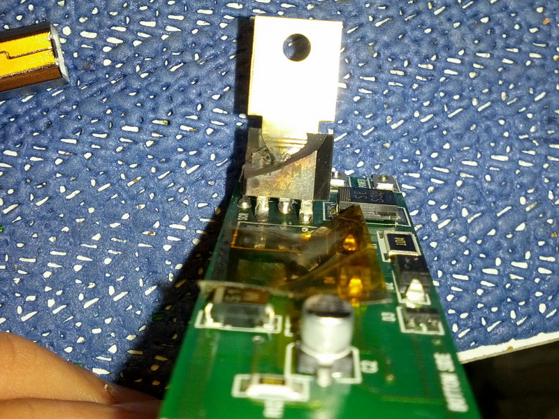

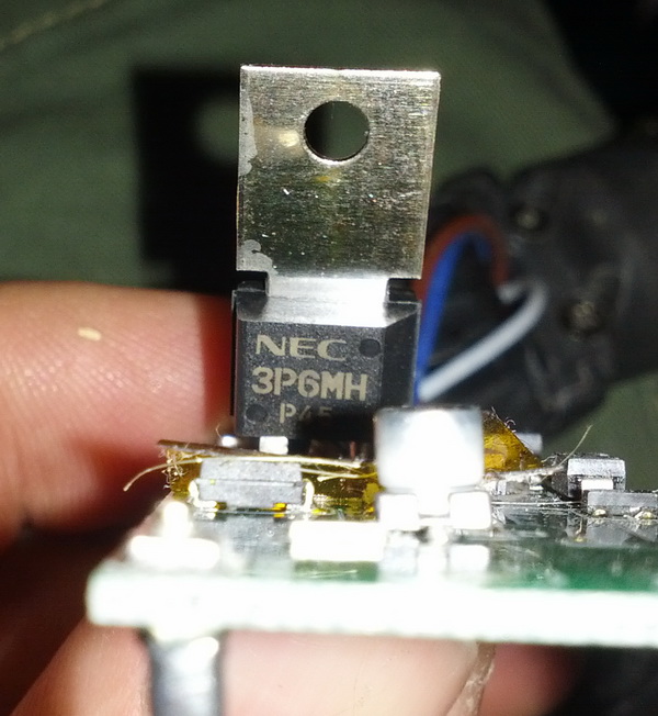

Hi all, I need to get hold of a NEC 3P6MH but can't seem to find one around?
I have found a datasheet but that is about all I can come up with?
Thanks in advance!

Probably available on ebay but it is not anything special. Should be able to use any general purpose SCR 3A ~700v TO202 package substitute.
I did check ebay and could find one, but it is very expensive at £6.25, I was hoping to find one on RS or farnell but not having much luck. Both of the aforementioned suppliers don't seem to do any in a T0202 package?
Good substitution would require knowing what the board does, and preferably a decent photo of the whole board.
Substituting just based on some datasheet specs is iffy. It's quite likely that once we know what it does then it might be perfectly happy with a device that has higher specs and will be more reliable. Also, do you know why the original part failed?

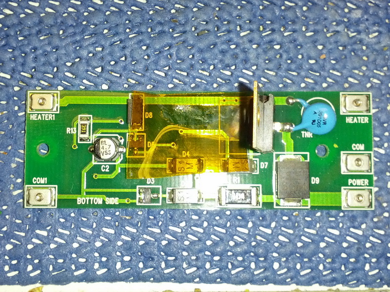

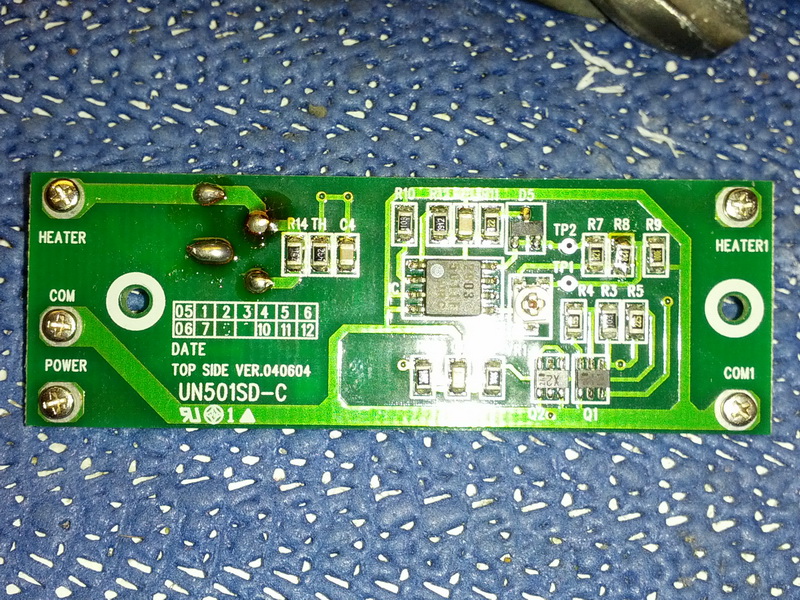

The board is from some GHD hair straighteners. I'm not 100% but I think this PCB senses current to regulate the heat, switched by the thyrister. Hope the photos help?
many thanks
I repaired a temp controlled soldering iron that has very similar control electronics. The opamp IC on mine was Lm358 (your opamp is a 2903) and did the zero cross detect and temperature setpoint comparison.
It's a simple phase angle controller so the type of TRIAC or SCR does not matter that much. Mine was an AC triac. Yours seems be half-wave only, as it runs the power through big diode D9 before the thyristor.
You should have no problems using a thyristor of higher rated current and voltage, provided it has equally sensitive gate current Ilatch (as the opamp will have a limit to how much gate current it will provide).
Also you didn't say as to the cause of failure, but that thyristor looks very much like it has seen massive current overload, ie a short circuit on the heater wires. It would be good insurance to put a fuse in series with the heater wires in case this might happen again. :)
