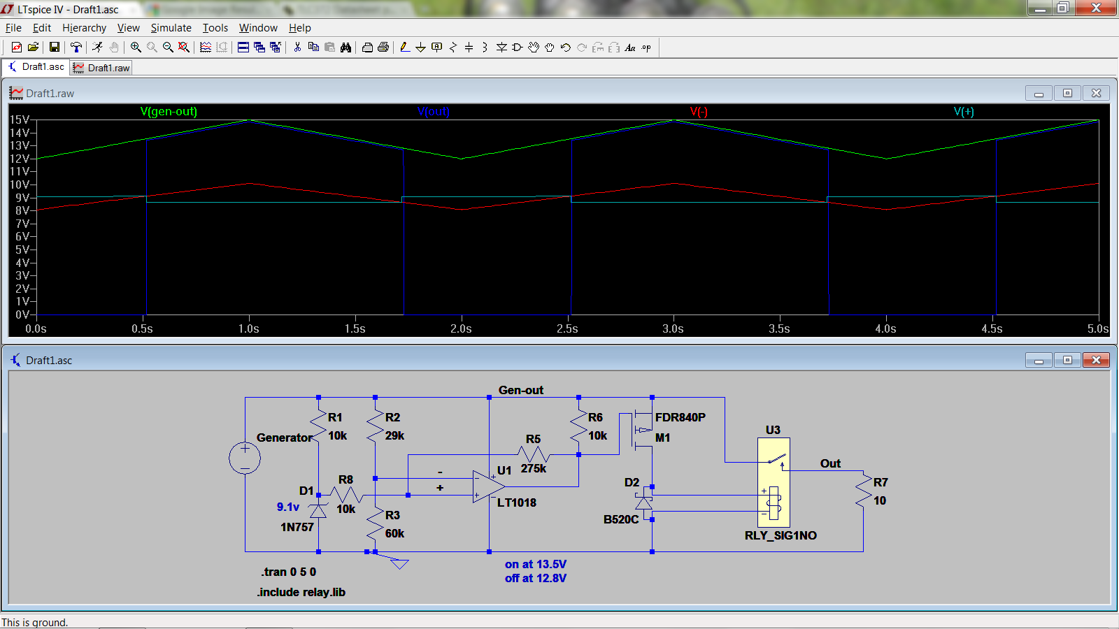

Im after some help if I may. My friend does alot of work with campervans and caravans, and installs quite a few second batteries running through split chargers. The commercial available volatge sensitive type retail about the £50 mark, but he has managed to buy a load of 70amp normal tpe relays, so has asked me if theres a way to make these into voltage sensitive ones. I've never done anything with voltage sensing before, withthe only thing close being dark/light sensors in A level electronics using potential dividers and opamps. Is there an easy (read cheap) and relaible way to make a circuit that would do it, but also have a schmitt trigger type switcing to it, so it would turn on at 13.7 voltage (engine running so alternator charging batteries) then off at 12.8. If anyone has got a circuit lying about that would be great. And if theres a way of making it out of single compnents rather than IC that would be brilliant, although if someone has got, or could design a pcb design for one, he could just get a load of pcbs made then solder them up.

how about an comparator with hysteresis
  • Draft1.asc
