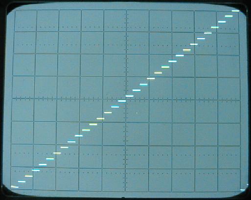

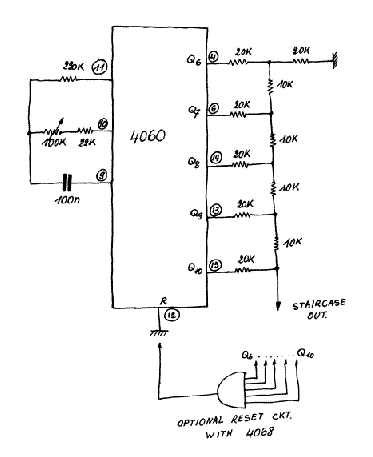

Hi Nre-the-8th,
I would like to suggest an alternative, a binary counter and a R2R
ladder network. Such a circuit could generate a staircase ramp which
should work equally well as a linear ramp. This circuit was based on
your first post when you needed only 30 steps. But if you add four
resistors you can expand the circuit to generate an (up to) 128 step
ramp if you also use Q4 and Q5. (Q11 is not available !)
on1aag.
You might have just solved my problem. Thanks for that. I will have a go with that circuit and see if it does what I want it to.
If you want the ramp to be monotonic (constantly increasing), your resistors will need to be matched to around 0.5%. The absolute value isn't particularly important, but the matching is.
