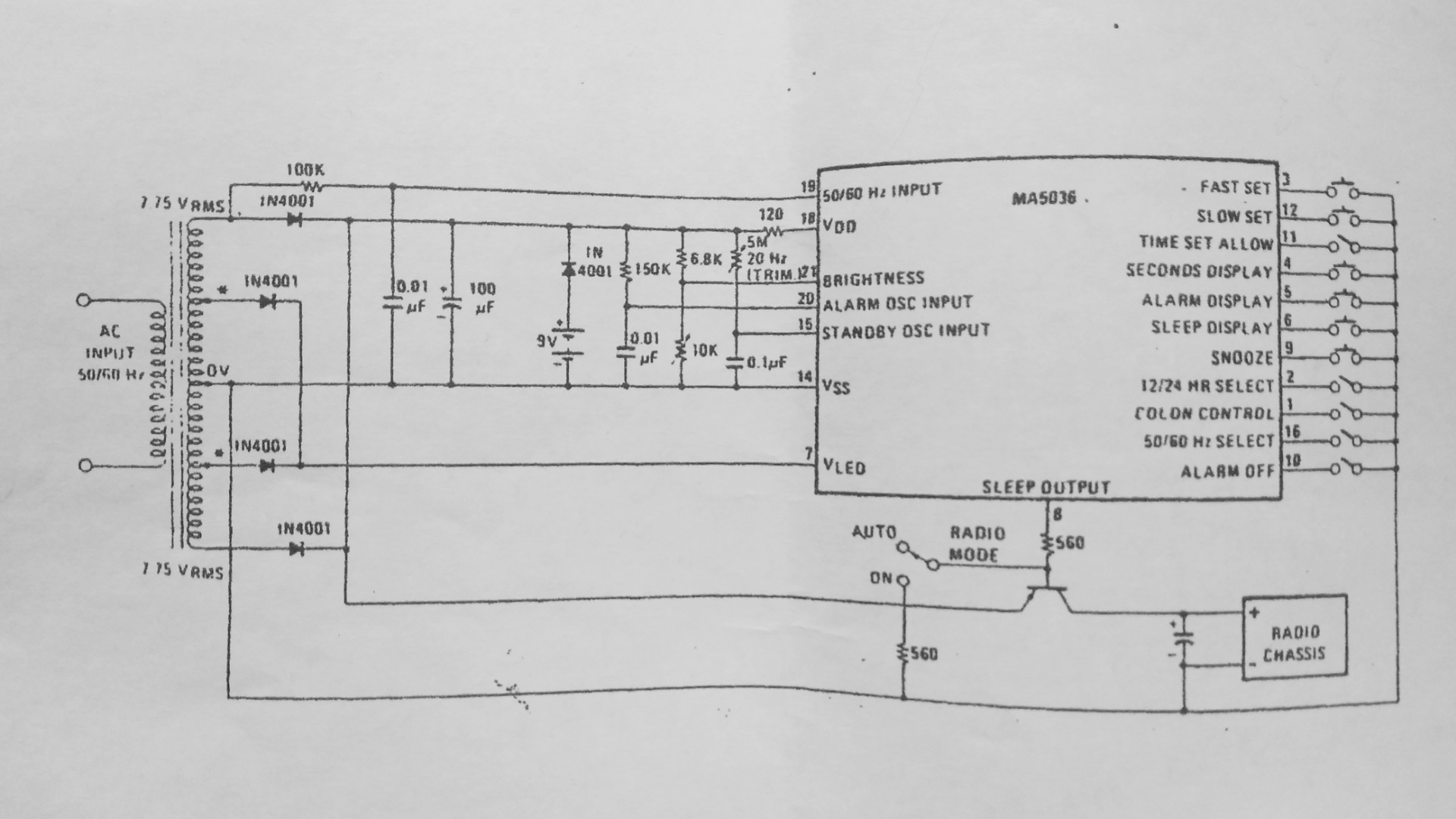

I have a National Semiconductor MA5036 clock module from the 80s and would like to build a compatible supply for it. I don't have a transformer with the same specs as in the applications notes and would be looking to use a commonly available transformer with a single secondary winding. I'd like some advice on building the supply for driving the LEDs.
The specs list VDD typ as 9v DC @ 5mA, max. 11v.
VLED typ. 2.5v @ 300mA, max 3.2v.
So I'm thinking of building a supply putting out 9v DC using a 7809 regulator, and for the LED driver supply... I'm not so sure. A regulated supply with 2.4v out off the same source feeding the 7809?
I don't need any additional supply for a radio or alarm as in the application notes, I'm just building a straight forward digital clock.
The scanned circuit should hopefully be clear enough but in case it isn't the secondary windings are 7.75v rms CT. The asterisks on the windings refer to 3.5v rms @ 250mA.
Thanks guys. I'm a bit rusty with circuits now as it's been about 40 years since I last built anything. I appreciate your help.
Dave

Bear in mind you need an AC feed for the clock (which comes off the top of the transformer in the diagram) - I would suggest you use a dual output transformer (these are commonly available, probably more so that single output ones) 8-0-8 would be nice, but you might have to settle for 9-0-9. Then for the VLed voltage, use a switch mode regulator to drop the DC output generated from the transformer. The clock AC feed would simply come from the top of the winding as originally.

Further to Nige's comments, the 50/60 hz input pin on the clock is used internally for keeping the time, so you need Ac.

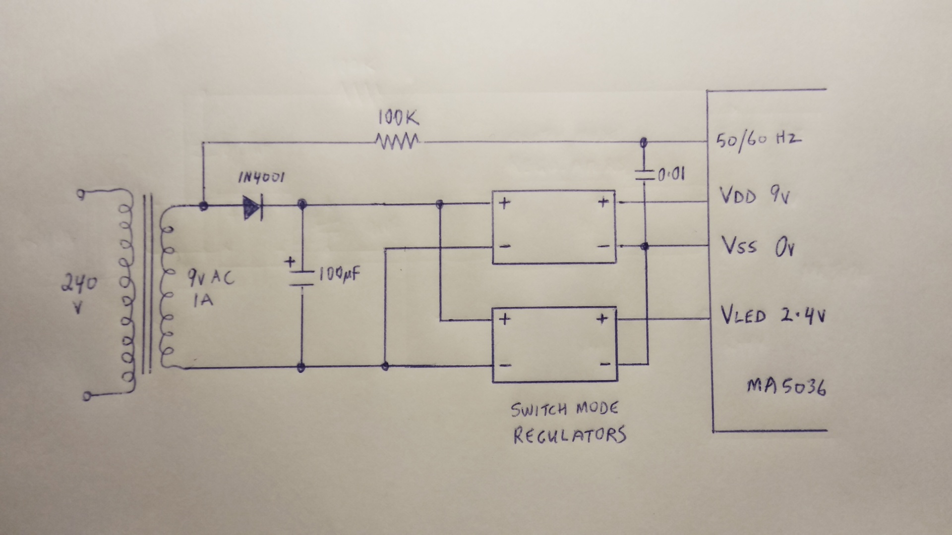

This is the circuit I've drawn up today using the suggested regulators from Banggood.
I realise I probably should have drawn it showing the 0.01uF connected to the 0v transformer secondary line rather than the regulator 0v output. I ran out of space to fit it in.
I'd possibly add a couple of electrolytic caps across the regulator outputs too.
I have a plug pack with 9v AC 1A output which is more convenient than fitting the transformer into the small clock case. I also have a 12v AC 1.5A unit but I think the 9v one should be okay.
Hopefully the switch mode regulators will have a common earth on the in & outputs.
Do you think this would be okay?

I would suggest that you use a full wave rectifier. I can't see any reason why not.
I agree with Nigel that 100 uF is too small, but I would suggest even larger than 1000 uF. If you are taking 1 A, and full wave rectifying at 50 Hz, then with a 10,000 uF capacitor you will get about 1 V of ripple.
That was my initial thought - but I'm not happy about no earth reference for the AC clock pulses.
Which was why I initially suggested a 9-0-9 transformer.

Thanks again for the suggestions. I thought that the half wave rectifier and 100uF electrolytic might be okay as the original design application notes used this, although I agree the 1000uF would be better. The typical current consumption at 9v is around 5mA plus the current drawn by the regulators. The current drawn by the LEDs is around 300mA. The original circuit diagram had no filtering on the VLED supply at all so possibly the 1000uF may be okay. It might be a case of trial and error.
A 9-0-9 transformer would be the way to go but building a separate AC supply is not ideal. I could try using the half wave rectifier and if not suitable would have to consider falling back to the 9-0-9 supply.
Thanks again for the suggestions. I thought that the half wave rectifier and 100uF electrolytic might be okay as the original design application notes used this.
No it didn't, it used a full wave rectifier, which means you can use a much smaller reservoir capacitor, which again, was why I suggested a 9-0-9 transformer.
Yes, you're right, I missed that. Okay looks like I'm looking for a 9-0-9 transformer. I should be okay from here on, my original question was mainly how to supply the 2.4v to the LEDs and those cheap regulator modules are perfect.
