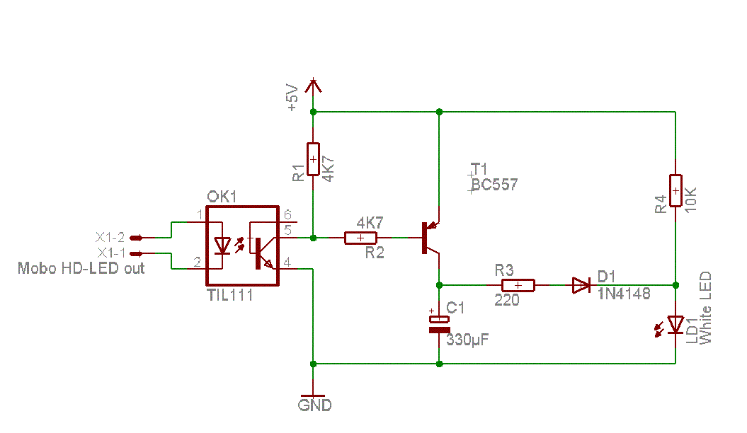

I have been modifying my computers for a few years now. Mostly just simple case mods, but recently I've been getting more and more 'advanced'. Well unfortunately, I don't have much experience with electronics, so everything so far has been additions to the case itself. In general, what I am looking to do here is to have 1 LED on my computer that appears dimly lit when the computer is on, fades up to full brightness when the HDD is being read, and fades back down when the HDD stops being read.
I'll try to explain this in as much detail as I can. I bought one of those really nice cool white LEDs from radioshack. "Typical MCD is 1100. Size is T-1- 3/4 or 5mm. Clear lens color. 20mA (max). Typical Voltage is 3.6V. Comes as package of 1." (That's what it says on their site, anyway.) On my computer's motherboard there are 2 connectors; one for the power LED, one for the HDD LED. They each provide about 2.9v. What I am aiming for if possible, is to have the LED lit up to about 1v, or about 20-25% of it's maximum brightness (powered by the power LED connector). Then when the HDD LED power comes in, I would like the white LED to quickly light up to it's full brightness. When the HDD LED power goes out, the white LED should slowly fade back down to it's dim brightness again.
I don't know a lot about electronics really. I can use a soldering iron, read a multimeter, read (simple) schematics, read resistor colors, and I have a vauge understanding of volts/current/amps/ohms... very vauge actually... Anyway, I'm just wondering if anyone here could possibly write up some kind of schematic for this, if it isn't too complicated. If it is, I'm willing to throw in a little cash tip for a well drawn out explanation and plan as to how I could make this happen. The main reason I don't want to just play around and try to figure it out myself is that it's dealing with my computer... I'm not prepared to fry my motherboard just yet. :twisted:
