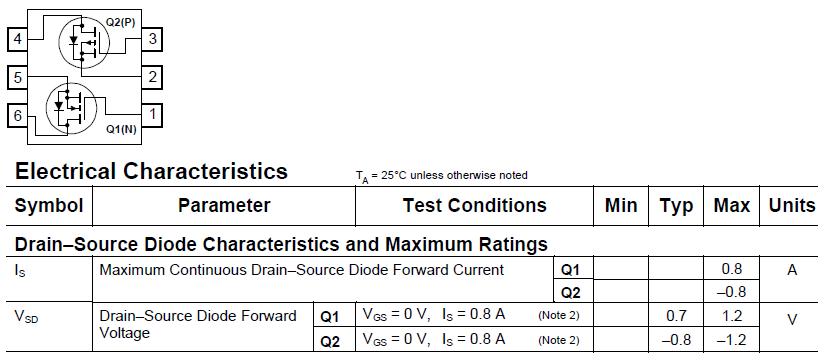

I have a question please, not related to BJT and relay.
I found a N-channel MOSFET that has a diode across its Drain-Source channel.
If the VGS is lower than VTO, then IDS should be zero and therefore VDS becomes VCC (assuming its source's connected to VCC).
In my case, VCC = 5V which is larger than the VF of the Drain-Source diode.
How come the diode doesnt start coduncting current and therefore increasing IDS from 0A to IF of the diode?
Thanks.
Because the diode is reverse biased.
Thats the thing, the anode is connected to drain, not to source, so its forward biased.
Take a look please:
relay-jpg.26543
That's a dual transistor, one N-channel and the other P-channel. The drain of the P-channel device (Q2) is connected to the anode of its diode.
The drain of the N-channel device (Q1) is connected to the cathode of its diode.
