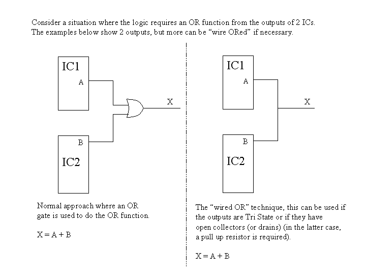

As for the multiplexing, you could use the 4052 Dual 4 channel analogue multiplexers as these can be wire "ORed".
Another possibility would be to use Tri State devices. I don't know if there is a Decade counter with Tri State outputs. If not, you could use Tri State buffers. The point is that Tri State outputs can be wire "ORed".

First, what does "ORed" mean?
Second, I have outputs switching between 1, 2, 3, 4, 5, 6, 7, 8, if I connect outputs 7 and 8 to ground, it will effectively wait for two switches in between 6 and 1. Is that effective?[/quote]
I should have used the term "wired OR". This is an OR gate created by wiring. I'll post a diagram with my next post (in answer to your next post)

Yes, this is correct. The attachment is the promised "Wired OR" explanation.
You may be able to also find an explanation on the internet
Len
