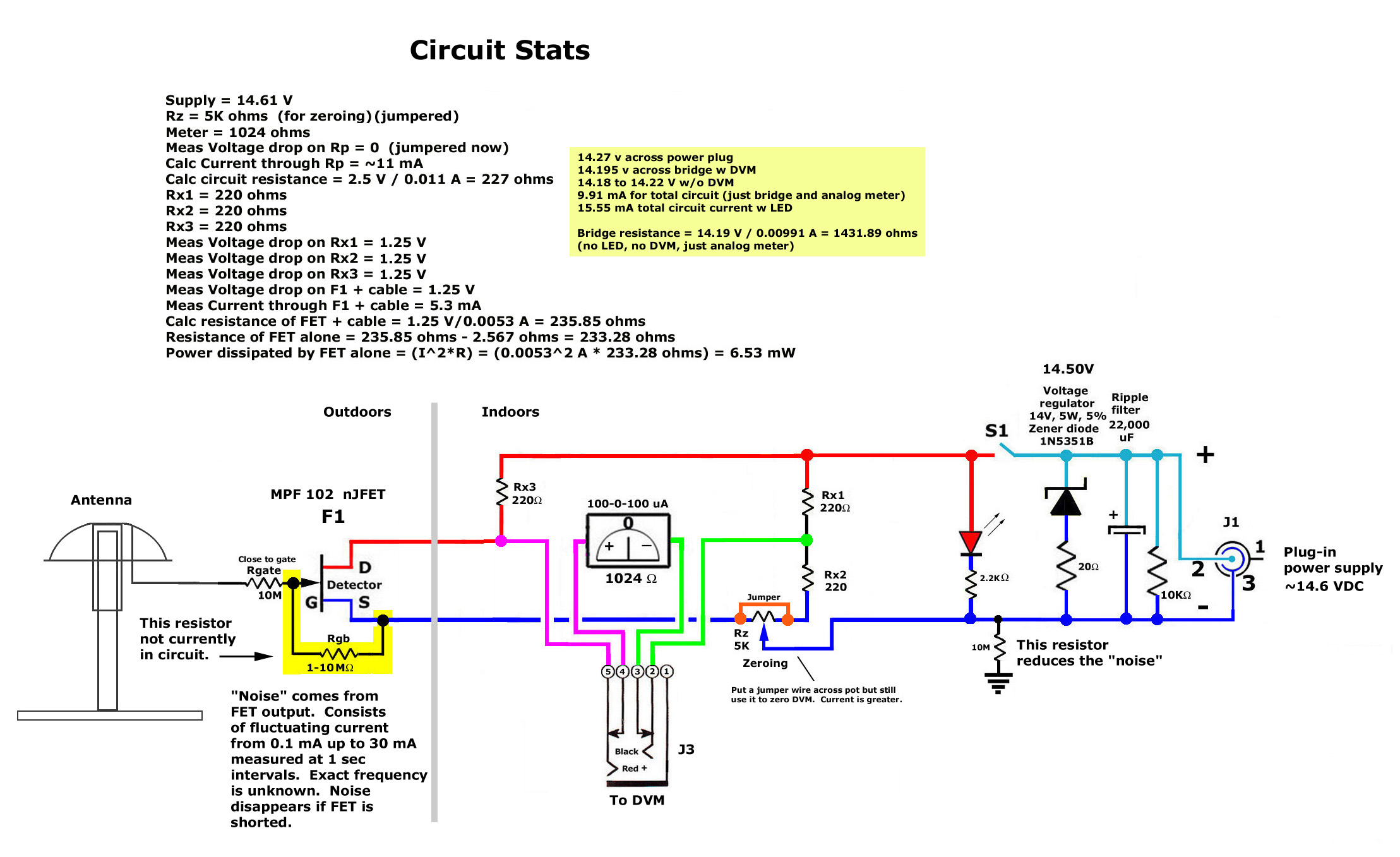

In the attached schematic there is a resistor shown highlighted in yellow connecting the FET gate to source. This is not in place at the moment. Would adding this resistor help?
Also included on the schematic are various measurements and calculations I've made on the circuit.

You show Rgb from the FET gate to source as not being in the circuit. Have you tried that resistor? That should stabilize the bias.

The resistor from gate to source, Rgb, has not been tried yet. I plan to try it soon. I've tried everything else I could think of on the indoor part of the circuit.

I just tried connecting Rgb (1.5M) between the gate and source lines. It did not stabilize the erratic current. What it did do was to reduce the signal to 1/4 its original value.
I then air-wired the gate to the antenna to be sure no PCB surface currents were affecting the gate voltage. This appears to have had no effect.

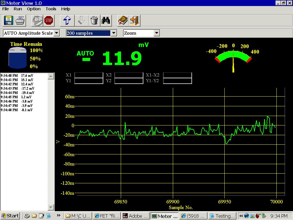

Here's a sample of what the "noise" looks like:

I was just trying to get the 50 feet of wire out of the loop. It's not clear to me that any noise on the source is not like an input to the gate. The whole thing is very sensitive -- are you sure it isn't telling the truth? I have no idea what the output should look like but i guess quiet unless your outside brushing the dog on a dry day :=)

I am assuming the noise is from gate input since I can't find any other source. If I remove the FET the noise disappears.

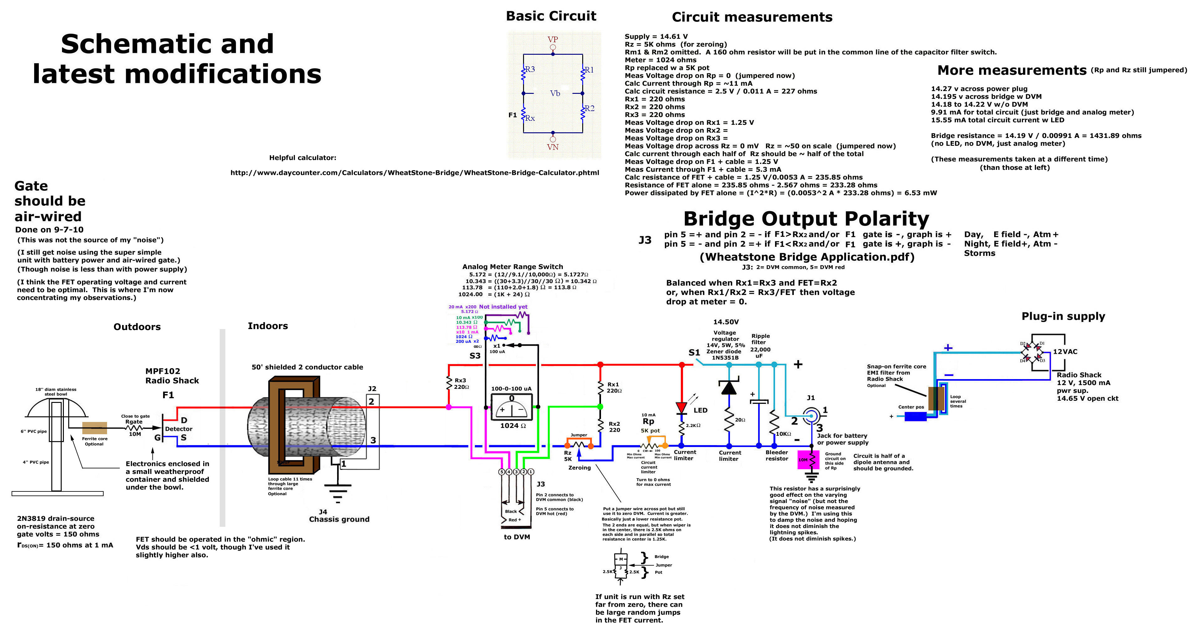

I'd be happy to share what I have. I've attached the latest schematic with some notes. Feel free to contact me anytime with comments or questions. This began as an extremely simple, tiny circuit which I've been modifying bit by bit.
I was hoping to be able to detect the approach of charged thunderclouds overhead as a warning that a storm was approaching. At present it is not sensitive enough for that, maybe because it is right next to my building, but it does appear to detect the daily variation in atmospheric charge and my graphs match published graphs of diurnal atmospheric charge.
To monitor the data automatically I bought a Radio Shack digital multimeter, catalog number 22-812, for $50 which comes with a serial cable and software. It can run for up to 5 days sampling once per second and it graphs the data continuously. I save the graphs with a screen-print program.
I'm currently working on what should be a more sensitive detector and have several schematics of those circuits also. They are also simple.
