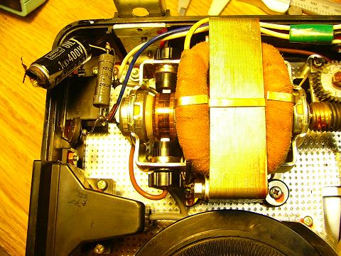

I've got an old Canon S-2 film projector that had been stored for quite a while.
I proceded to try it out, switching things on / off and so on over prob 10 mins, then suddenly the inside capacitor blew out. Left my left ear ringing for a while. Anyway I'm not sure of it's replacment equivelent.
Anyone have experience with these ?
Look at the value and voltage rating of the capacitor, if no other components have been damaged when it exploded, it should be fine if you replace it.
I'd recommend replacing all the electrolytic capacitors to ensure it doesn't happen again.
It's the markings on this old cap that I'm not sure about. I'm not used to working on something from the '60s.
Says .1 (k) 400v
It is .1 uf (100 nano) isn't it ?
Picture of where it is in the circuit attached.
Resistor is the grey wirewound shown in the picture. It's about an inch long.
Motor is DC variable speed by rheostat.

Yes, it's 100nF
The capacitor looks like an RF suppression capacitor so it might work without it. I'd recommend replacing it with a 400V 100nF non-polarised capacitor
Is just connected across the mains supply as per the schematic above? Or are theose components connected across the motor? It looks like a snubber network.
Have you checked the rheostat and the motor resistance?
Yes direct across the mains. As per my drawing.
RF suppression is what I thought. Don't know what the resisor is supposed to achieve and I could prob clip that out too. What do you think ?

The resistor is to discharge the capacitor, so you don't get a shock from it. The unit will work perfectly well without them.
Yes, just don't complain if there's noise on your audio system whilst the projector is running.
Yep, agreed
Ah...of course...This unit has an auto reel for the cord. A shock from the cap could happen while holding the mains plug pins to slow it's retracting.
