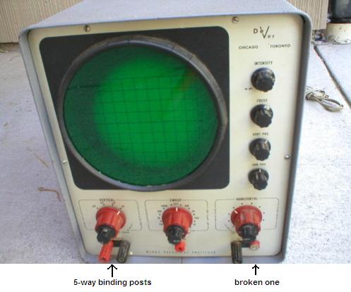

a Devry Institute of Tech.Oscilloscope? Don't have picture but I'll try to get a picture of it uploaded. I was told it was a project kit for the correspondence course. There are no serial numbers or part numbers on it. If anyone knows where I could purchase a probe for it, or if they make some kind of universal connectors for probes could you let me know. I'll try to get a picture of it uploaded. Thanks

A photo of the 'scope on Google (it looks like it is very old) shows "binding posts" as the input connectors. Then any old shielded cable (audio cable) can be used to connect to the input.

Yes audioguru thats it! Where would be the best place to order the probe? Thats the exact same one; the vertical input is .01 to 10k volts per cm
the vertical input is .01 to 10k volts per cm. The Sweep is 10 to 100k frequency and then the otherside of the sweeps 1 to 10k time per cm. What would you recommend and from where? audioguru found the picture of it on Google (the last place I thought to look).
Like I said, the 'scope looks like it is very old so nobody sells a probe set for it. Simply make your own probes with shielded audio cable and a thick copper wire probe or alligator clips.
