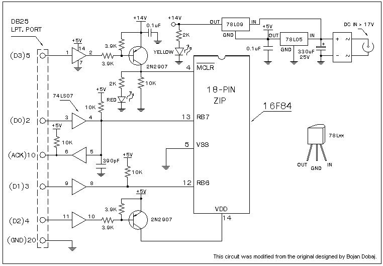

I have a programmer as shown in the pic. but I have no suportted program for it. can someone help me plz?

This is a basic programer.
What chip are you programing?
WinPicProg by Nigel Goodwin
IC-Prog
go into the Hardware settings and set the pins of the port
Hint: D0=Pin2
If you need more help just ask.

So, what you are saying is that you cant change the lines of the programer hardware, right.
You should be able to go into the hardware setup of the software and make them the same as the programer.
What software have you tryed?
If you can't, please explain.
Kent
I changed the hardware....
now when I program the pic, it doesn't pass the verify....
there are places where it is program, but it does not program all posible options. and sometimes it program one and read something else...
I think I have bad PIC. I will try to buy another one....
Thanks for the help.....
Get WinPicProg by Nigel Goodwin
In the hardware setup
set Vdd to D2 and Invert
set Vpp to D3 and Invert
Set Output to D0
Set Clock to D1
Set Input to Ack and Invert
Port $378 (printer port)
Let me know, details please
kent

I bought a new pic16f84A. The programmer didn't program it too. :cry:
I don't know if it is meter, but instad of 74ls07 I have 74ls06, I inverted output(D0), input(ACK) and clock(D1).
and another point, when i read information from the pic the vpp led is blink. should it be like this????
in the normal work of the pic MCLR should be 5V. on the reset this pin should be 0V and in programming mode 14V.
I think that when I read the info the programmer delete it from the pic...
Am I right???
What should I do to fix it????
