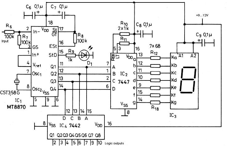

Howdy all, I'd like to start a project where I want to somewhat duplicate the lower end R/C car radio controls. The ones in particular that I am interested in have forward/reverse/stop and left/right/straight. Does anyone know of a good book or website that talks about these types of things in depth. I've got some info on simple audio transmitters/recievers, but nothing on how to enconde/decode a signal like perhaps TTL. I am hoping that I can find a way that will let me use fairly easy access components and stay away from PIC like stuff. Any ideas would be greatly appreciated. Thanks in advance.
A possible and cheap solution: transmit DTMF signals via audio channel
with MT8880 (or other) DTMF chip. You can transmit always only 1 of 16 command.
another solution is nationals lm1871 and lm1872 the 71 is a 6 channel transmitter and the 72 is a 6 channel reciever using pulse width mod for servo's..really ita 4 channel either way plus 2 digital on-offs for toggle switches no pics controllers there just good ol simplicity...both are good for upto 80mhz if thats the range you like...do a search for lm1871 or lm1872 you be glad you did....
Sebi, Do you know of any decent DTMF schematics that are avaialble on the web?
gunny, those chips look quite interesting but when researching them I find they are discontinued. Anyone happen to know of a source for these chips?
Thanks for the info!
A good startpoint to DTMF decoding.
