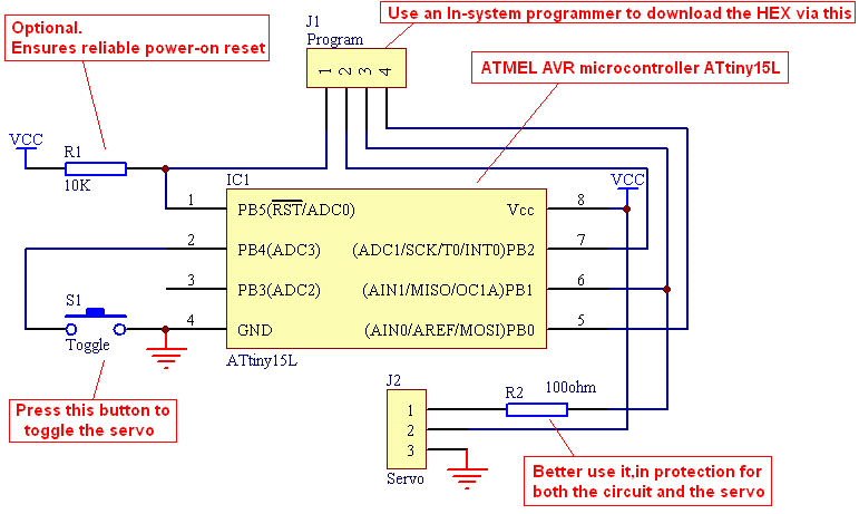

It is a simple circuit with only a 8 pin ATtiny15L and a couple of resistors.
**broken link removed**a picture of it.And **broken link removed**'s a webpage for it(hope it will open),don't bother reading the text.Just check the pictures and the video.
The system always powers on with the servo restored to an initial position.When you press the button it turns to the other position.Press the but again it turns back.
The scheme is simple and I will try to draw it asap.The code is also simple.Anyway you don't even to read the code because I have the HEX file here.Solder the circuit,get an ISP programmer and download the file into the chip,there you go!
Whether you want it or not,I will prepare it for you.
Here it is.Look at the attachments below.There are more resistors and a transistor in the picture from the link.They were built to light the LED supporting my ISP programmer.You can ignore them.

Alex: Shouldn't you have a pullup on that button? It seems to be just floating there.

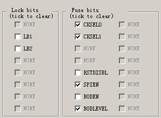

*Note,AVR microcontrollers have "lock bits"and"fuse bits" inside.My application doesn't need any modification to these bits.Make sure these bits are kept unchanged.Improper settings will disable the accessibility of the microcontroller permanently,and waste a good reprogrammable chip.If you can't be sure that the programmer in hand leaves the settings alone,either read them out first or set them as shown below,then write them back.("clear" means the bit=0)

One thing I have to let you know is that this PWM servo control implementation MIGHT SLIGHTLY exceed the servo travel.Though the possibility is extremely low.If it ever happens,replace the servo with one of different type.Or try to get a programmer.Modify these two lines
   ldi   r17,$75         ;initial servo location
   ldi   r16,$7A         ;75-7A range(resolution not really good)
of the code I posted above.Then content of r17 and r16 determine the two positions of the servo arm.Try to adjust the numbers to get your best angle.
