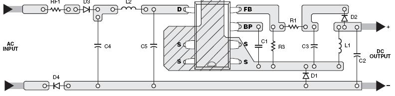

the suitable part
see attached image pls,I think this part is suit for you.

What's the code of that IC? >_>
It looks like any simple switching regulator.
However, to my knowledge (And I just did a quick search) there are no switching regulators capable of taking in over 100V directly. Where it says "AC In", they likely mean the output from a transformer.

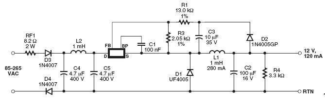

see attached image please,you will like it
AFAIK, most switching regulators won't be able to take in line voltage like in that schematic. You'd need a transformer.
Actually a transformerless power supply would do exactly what he wants and very cheaply and efficiently as well. It's just three diodes, two caps and a resistor. There was a long thread talking about them recently. The only downside is no line isolation, so you have to figure out some method of isolating your circuit from your I/O stuff that you connect to the outside world with (optocouplers, etc).
It's not so much isolation from mains voltage that's the problem, it's that there no current limitation without an isolation transformer. If the primary capacitor fails short circuit you're going to have a ball of plasma on your hands.
@speakerguy: Can you give the schematic about your "just three diodes, two caps and a resistor.plus the fuse and optocouper" ??? n i don't want to have a ball of plasma in my hand... Thx
The optocouplers would only be used if you had metal connectors on the outside of the project box to connect to other devices. If the device is self-contained then it does not need them.
