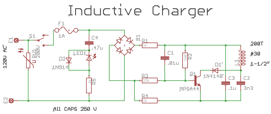

120V AC is going straight in there? wow! I guess I will add a fuse, is 1A ok?
Should D1 on my schematic be 1N4148?
This is better for the eyes:
Edit: Forgot to say I made a few mods, Bridge(for clarity), Switch, Fuse, LED + Resistor
Mike

hi Mike,
Do NOT build that circuit you have posted, if you plug that into the mains you will get a bang and a dark brown smell..!:eek:
Thank you Eric for the warning,
But is it something I did wrong or the circuit all together?
Is there anything I can do to improve it?
Mike
Mike
Mike,
Consider that 1K and LED across the rectified mains, they have 170Vpk across them, so that about 160mA thru the LED and 17Watts dissipation in the resistor.!!
The two 1K' s in the +V and 0V rail dissipate about 5W each........
If the component values are correct then the 60kHz appears as just a short burst near the positive peak.??

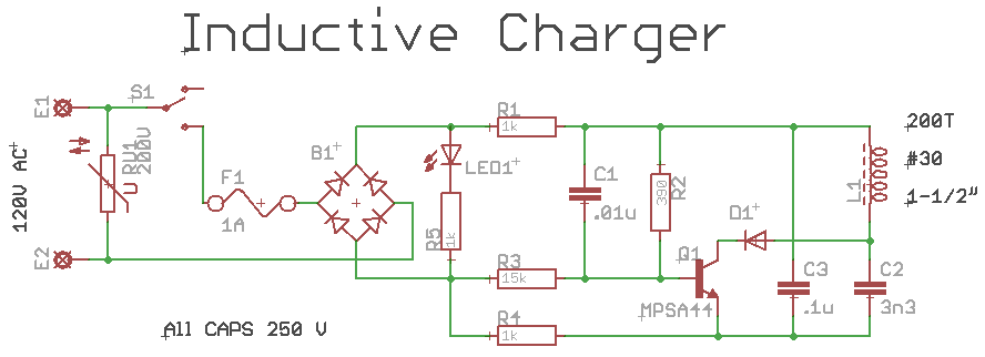

Ok, I see what you mean.
Does this make more sens?
I am in the process of learning LTSpice so eventually I will test my circuits before I post them.
Mike
A few questions on the circuit from previous post:
1 - If I want to recharge 10 devices or more, is it ok to connect 10 coils (L1) in parallel? otherwise do I have to replicate 10 times all components after the bridge?
2 - About the coil, 200 turns of #30 on 1½" I guess 1½" is the external diameter of a tube where the coil starts to be rolled around. Does it make a difference how many wires will be side by side or row by row as the next row will have a diameter slightly larger than 1½" and so on for each additional row?
3 - This will probably have the same answer as #2, will 199 turns or 201 turns make an important difference (based on what I am using it for)?
(My first experience with coils)
Mike
The inductor is part of the 60kHz osc circuit, so you cannot parallel more coils.
Its the outside diameter of the blank former.
Make the length of the winding as short as reasonable, dont forget the coupling required to the remote pick up coil.
No problems.
Mike
I would initially build the circuit and debug it.
Calculate the wattage of the resistors used, also remember there is no mains isolation so the circuit is a shock hazard and could kill.
