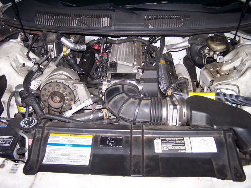

Ok wait here, I got my cam, Let me show you mine:) I am going to shoot a few pics.
Ok, here is mine...
Since you seem to have a gearhead background, can I assume you can fab parts from metal? This is only relevant to plan A, as I still see this as the simplest solution. I will send you a schematic soon of plan A. Plan B to come later.
