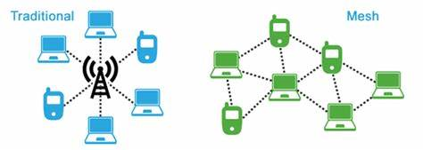

Have you looked at Z-Wave?
I've played with it a bit but I'm not really using it for much yet.
The mesh concept and every device being full two way seem very nice compared to some older systems.
Z-Wave is "mesh network" 900mhz. I like mesh and 900mhz. Again 900mhz requires remote devices to talk only 1% of the time.
You can transmit data fast for a short distance or transmit data slow for a long distance. I think Z-Wave is faster then LoRa but the distance is not as good. Several you-tube people have problems with distance with Z-wave.
If you are looking to extend your WiFi; I see NetGear has "mesh" network extenders. They claim to "hop, hop, hop" your network out some distance.
I have not tried mesh (out side of Xbee).
