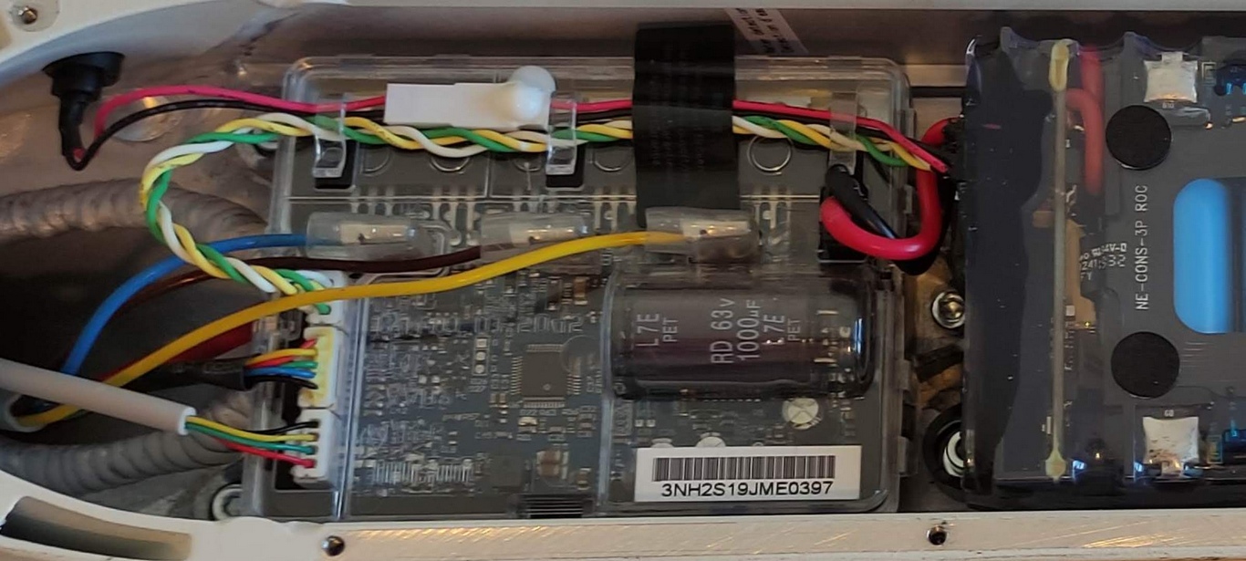

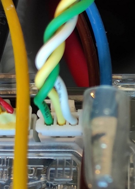

Hello everyone,
I have a Dataline cable (3 twisted wires, see photo) which is 15 cm (6 inches) between a battery and a control board.
I need to bring this length to about 100 cm (39 inches).
Could this increased length cause enough signal loss to confuse my application?
The gauge of these wires is 22AWG, I do not know the voltage, nor the intensity running through them. They are twisted (see photo) perhaps to limit interference.
Thank you for your lights !
I will say The 100 cm length will be OK - based on the photo of the cable.
Typically, the workable length of the cable depends on:
1) The amplitude of the data signal. A 15 Volts amplitude signal can traverse longer distances than a 5 Volt signal.
2) The Data Rate. A lower Data Rate signal can travel longer distances without errors than a High Data Rate signal.
3) Normally, a thinner gauge wire will cause more attenuation than a thicker one, but for the distances mentioned, the 22 AWG will should be fine.
If you can tell us the Data Rate and its amplitude, you can get more specific comments.

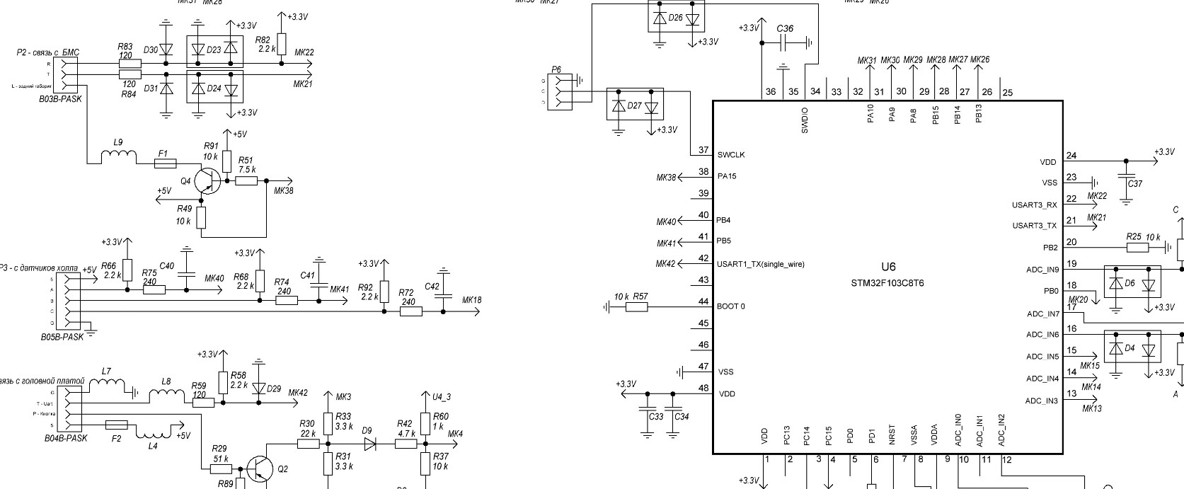

I found the shematic of the control board, it corresponds with the photo (dataline plug in P2, top left of the picture):
Not sure of the signal amplitude, maybe 3.3V with both RX and TX signals.
I was told that this dataline cable is used to calculate the battery life, and to manage the power supplied to the motor; Can this give an idea of the data rate?
Is twisting the three wires enough to solve this question posed by the length of the extension cord?

I have no argument with the benefits of twisted pair etc., I use it all the time in both my own gear and industrial gear I work on or design.
However, I can only guess you have not actually looked at the device schematic and have no idea what the signals on that cable are, beyond assumptions?
Twisted pair also reduces crosstalk - https://en.wikipedia.org/wiki/Twisted_pair
Every mention of crosstalk in that article relates to crosstalk between pairs, in balanced line systems.
Twisting together two or more unrelated signal wires, as they are in this device, cannot improve crosstalk anywhere!

Schematic and OP references clearly show they are USART Rx and Tx .....up to 4.5 Mb/s

For any of that to apply, the signal must have no overall signal current in the bundle; either overall balanced or signal & ground in each pair, so all signal current is within the same pair (or each triple/quad etc).
Balanced current means minimal or zero net field, signal radiation or signal coupling at a distance from or to the pair or bundle, and the twist means any stray coupling that does occur it likely to be shared by both (all) conductors, so mostly nulled out.
That is the essence of why twisted pairs (or triples/quads as appropriate) are so good at minimising stray emissions or noise pickup.
None of that applies with this piece of equipment; it's three totally different and separate signals with ground returns via a completely separate path.
Each has an external current return via the main ground, NOT part of the twisted bundle, so no magnetic field / interference cancelling.

Thank you all for your nice expert answers, I can move forward with my project now.
Just one last question:
The device is an electric vehicle (note: only legal modifications).
The dataline extension will come out of the vehicle, and will be very close to another extension, that of the power supply with a maximum current of 20 A.
Will it be necessary to add a shielded sheath around the dataline cable (see photos), and connect the metal shield to the aluminum body of the vehicle?
I don't know if screening will help; it may reduce interference pickup, but also increase capacitive loading, which could affect the signal - that all depends on the data rate.
My main concern is voltage drop on the battery ground. If that becomes significant due to a longer cable, the "ground" offset between the battery monitor and main circuit board could get large enough to affect the data wire voltage levels and disrupt the data, or even cause damage.
(You are in effect adding a resistor between the battery negative and circuit board negative, so under load the circuit "ground" will have some level of positive voltage offset relative to battery negative).
Make sure the battery negative cable is adequately sized so the voltage drop on it does not increase too much, or bond it through the vehicle metalwork if the system is grounded to that anyway?

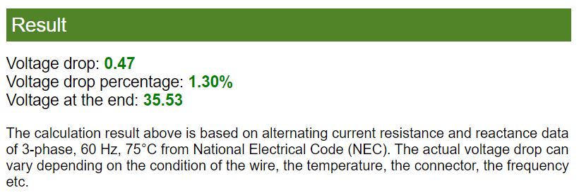

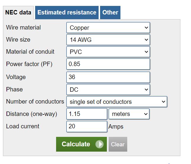

I've tried several "voltage drop calculator" to check the power supply (battery) extender.
Results: between -1% and -1,30% (= -0,47V) in the worst scenario (20 amps)
With these parameters:
Battery: 36 V nominal
Wire size: 14 AWG 200° silicon
Distance (one way, same for positive and negative): 1.15 meters (45 inches)
Load current: 20 A (there is a 20 A fuse on the control board)
I don't know if these -0,47V are ok or not.
The data levels are only between 0V and 3.3V, so 0.47V is quite a big chunk off the noise margin and may be enough to invalidate the logic levels, depending on the receive thresholds at either end.
