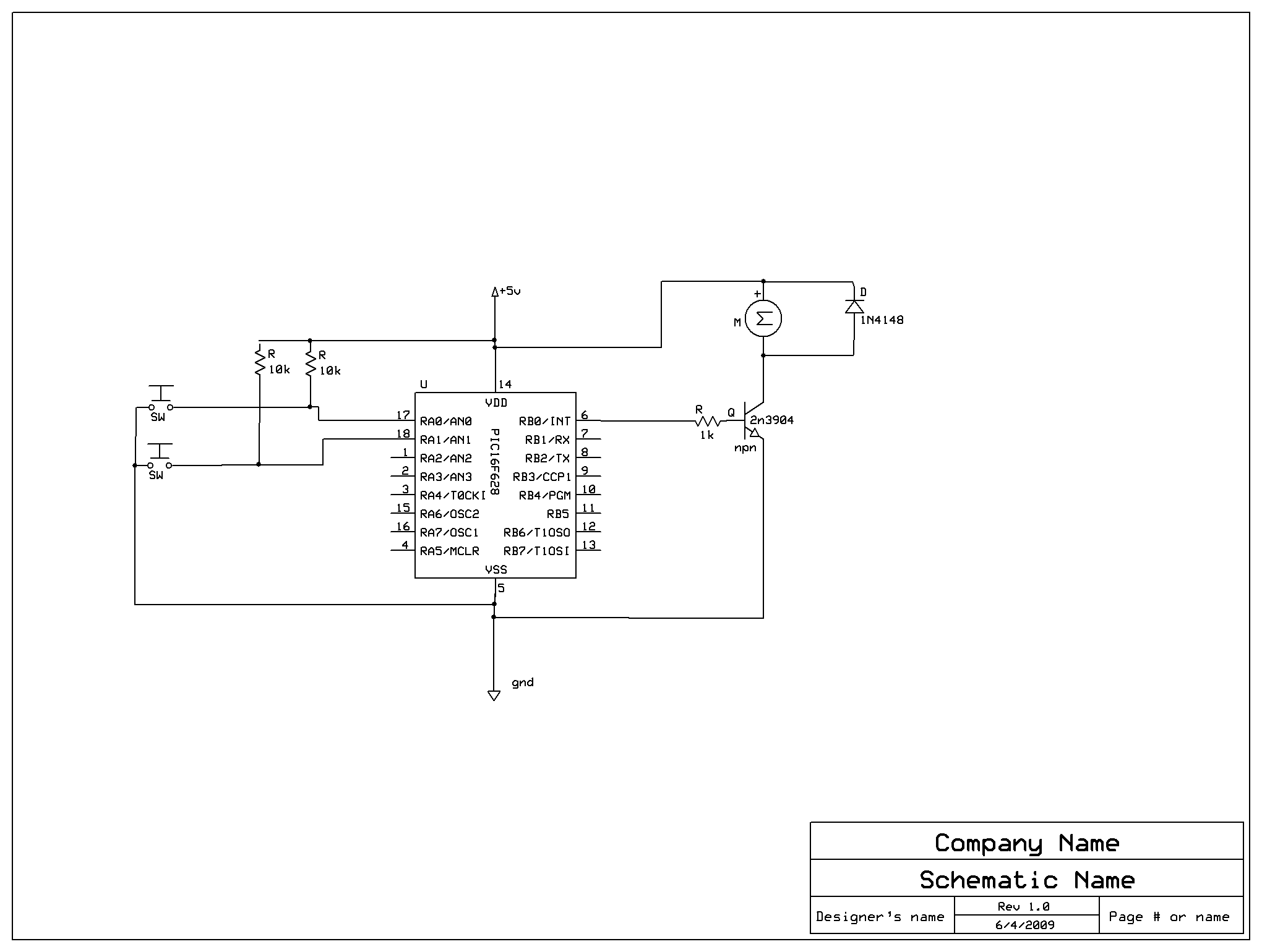

Here a simple wiring layout for a small motor up to 300mA

Thanks for replying so soon!! It looks like good information and I'm anxious to go home and delve into it.
