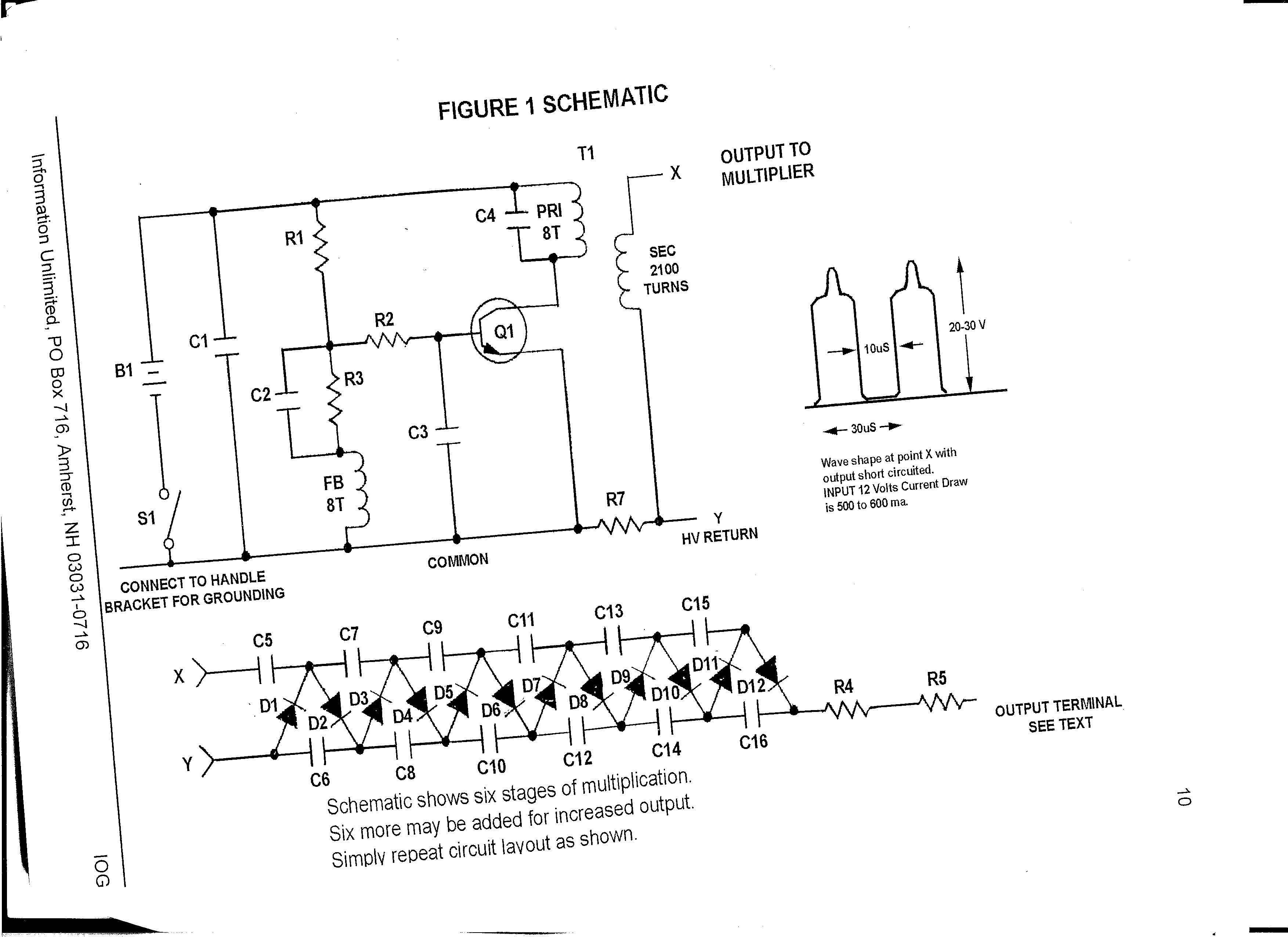

Mishael
R1 2.2K 1/4W Resistor
R2,7 27Ohm 1/4W Resistor
R3 220Ohm 1/4W Resistor
R4,5 100MOhm Resistor
C1 .47 MFd/50V Capacitor
C2,3 .047 to .068 MFd Capacitor
C4 1MFd 100V Capacitor
C5 .001MFd/15KV Capacitor
D1 22KV 5MA Avalanche Diodes
Q1 MJE3055 T0220 NPN GP Transistor
T1 2100:8:8
BH1 8 Cell AA Battery Holder
S1 Push Button Switch
CL1 Battery Snap Clip
HS1 Heat Sink Bracket
well ive got the obvious resistors so im good there but when it says something like .47 MFd, are they talking mega or micro ferrads? i saw a picture of them (this is for a project) and these are some of the biggest capacitors ive ever seen in large quantity
also, where can i find some of these things? i went to allied electronics and found some of the more obvious ones but say the avalanche diodes are hard to come by
Hi.
MFd is a very poor brained way to write the proper µF from a careless person.
As some typing has no access to the micro symbol µ, an acceptable form is the similar u instead.
So in your case, those components are microFarads.
100M is a very high value resistor, I'd question that.
If you post a schematic and I'll be able to tell your if it's right or not.
you have seen it before hero. im having problems understanding it myself

R4 and R5 are high voltage current limiting resistors to keep the current to a safe level.
Sorry but I think you should attempt a simpler and less dangerous circuit, try a 555 LED flasher or something simple like that.
