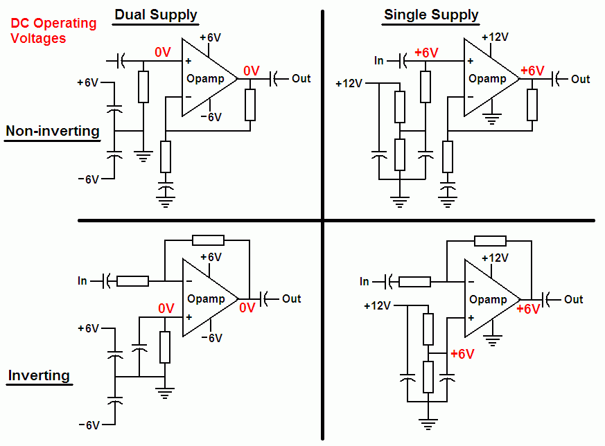

An old 741 doesn't need a +/- split supply. You just need to bias its inputs to half the supply voltage like this:
